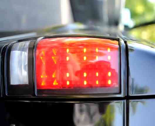

If done right, you can get those to look good, I have seen people do that and completely f- it up.
I am going to be redoing mind this summer, I am going to be getting some PWM's (pulse width modulator) so the whole board functions as one unit, instead of having dedicated LED's for brake/signal, and dedicated led's for running.
when the parking lights are on, the PWM will dim the led's by flashing them at 60-80hz making them appear to be dim. Then once you hit the brake or signal, it over rides that and puts the leds at full continuous power.
This is how I have them now.
basically with that setup, when the parking lights are on, and you hit the brakes, lighting up more led's makes it "brighter" it works pretty well, but i'm sick of it already.

I really like that too!! I don't think I could pull that off though. I'm not too great with wiring/electrical work. Between high school, work, and my girlfriend, Ifs a little hard to find time to work on it. How long did it take to do that?
