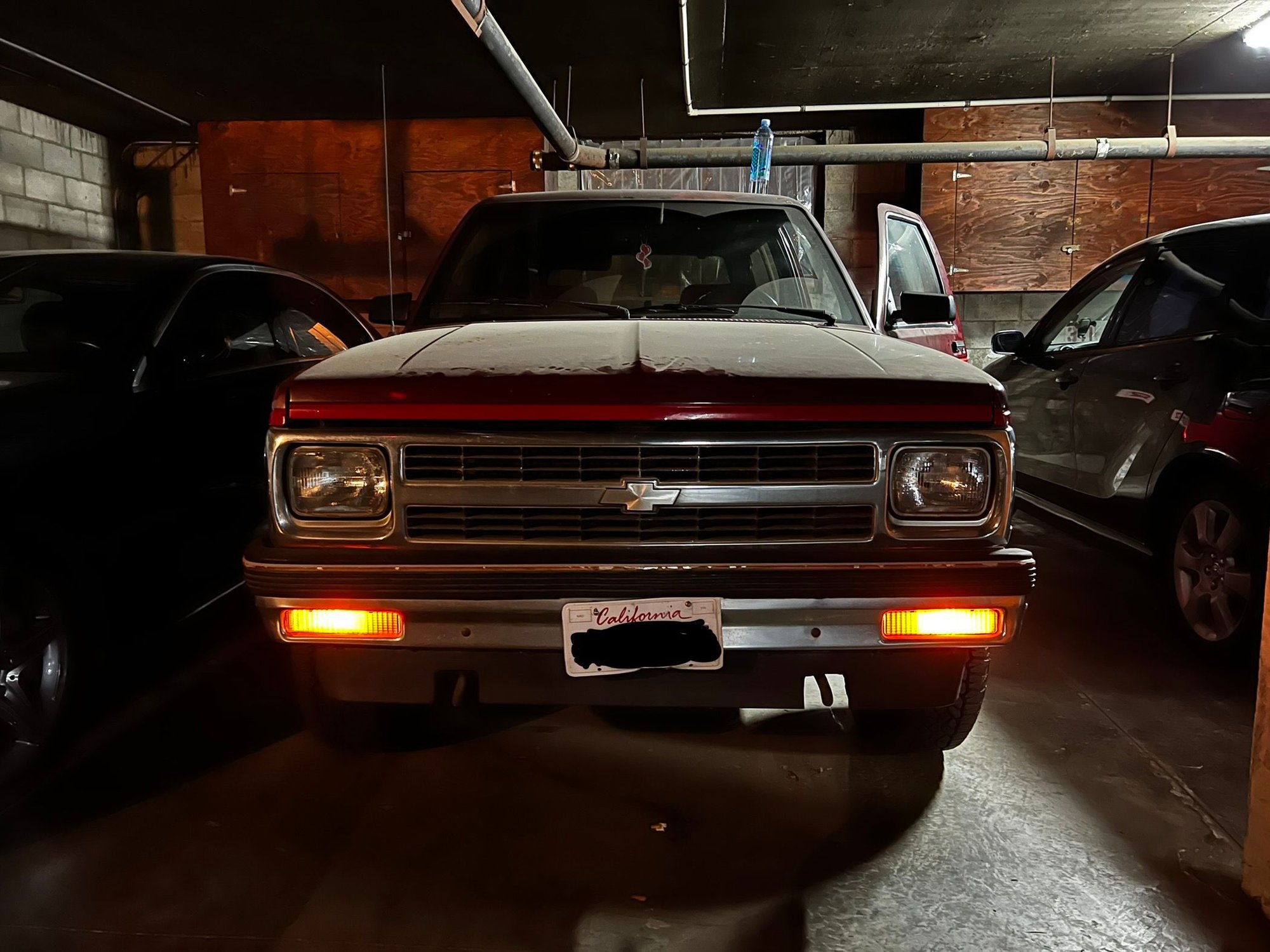

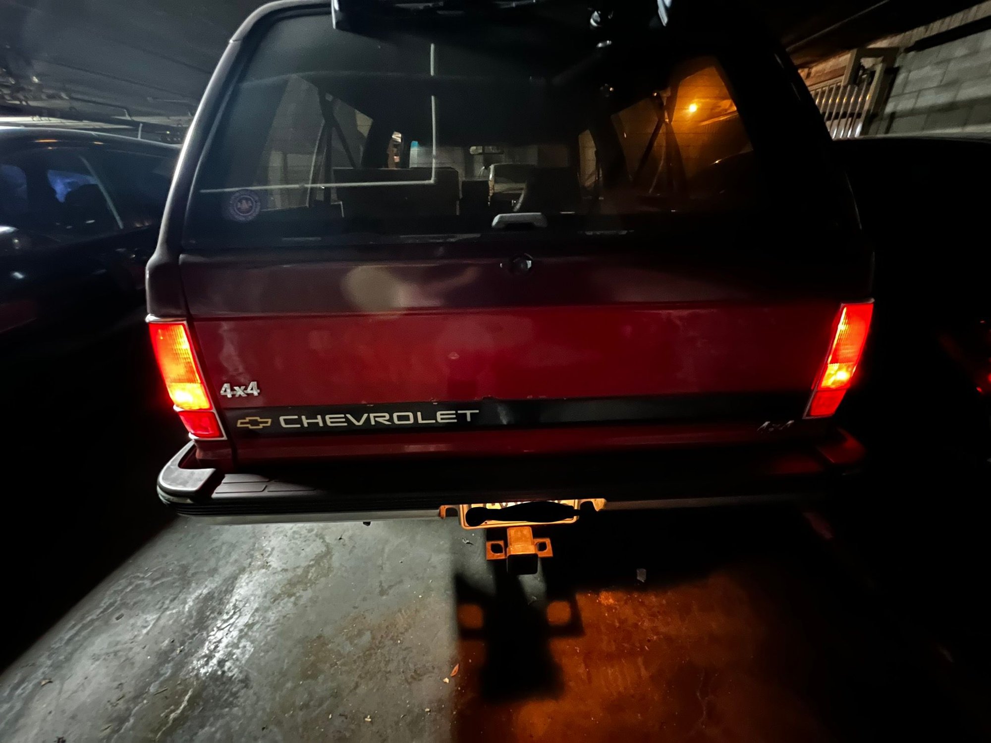

My license plate light, tail lights, and lil front blinkers stay on when the car is off making me have to disconnect the battery anytime I’m parked longer than an hour. Anybody have any clue what the issue is?

hey I just got around to looking at it been out of town awhile I made a video and posted it on YouTube cause it was too big to post here
Give it a watch and let me know what you think please
