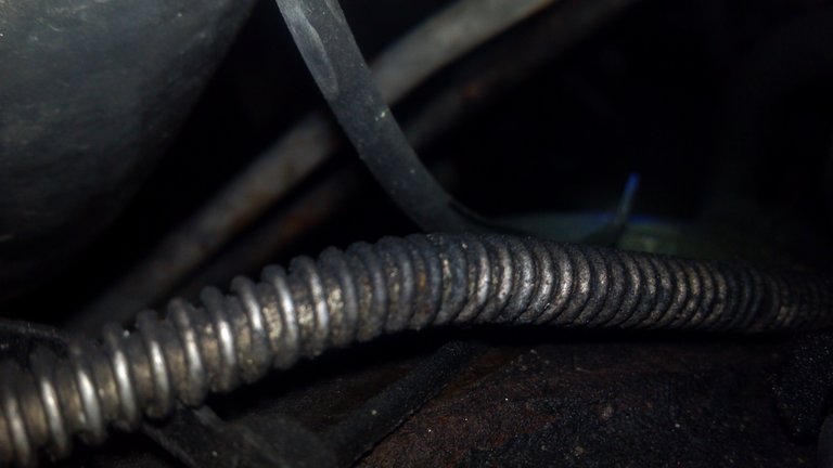

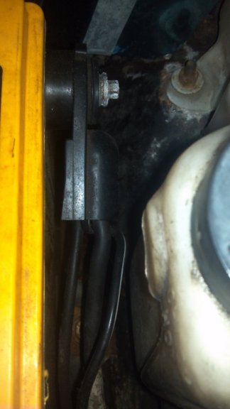

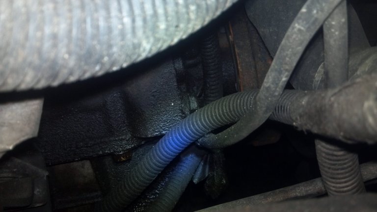

ok, here are some pics...hope they help
battery connection
block at front pass
frame near abs connector...pass side
i couldnt get the core support...it is below the battery tray.
Attached Thumbnails Wiring harness night mare-photobucket-20625-1364778151442_zps91091cf3.jpg   Wiring harness night mare-photobucket-35291-1364778148780_zpscedb68a8.jpg   Wiring harness night mare-photobucket-56709-1364778150505_zpse2105042.jpg

Sorry I cant tell much by the pics but if the ground is bolted to the battery to the frame its a ground right?My wiring harness is such a mess I cant tell heads or tails of it.I have a diagram I down loaded so it should help.I`ll see if I can get some pics and uploaded tomorrow.Also in last post I mis spoke.The black wire coming from the core support I fastened it to the smaller black wire coming from the new ground cable I bought.

yes, in the battery pic it shows three wires on the neg connection.
thickest goes to the block, the two small ones go to the frame and one to the core support.
yes, the engine must be grounded. in my stang the block is just grounded directly to the frame by a grounding strap. as long as you have the ground with a good connection i dont think it matters where as long as its made.
