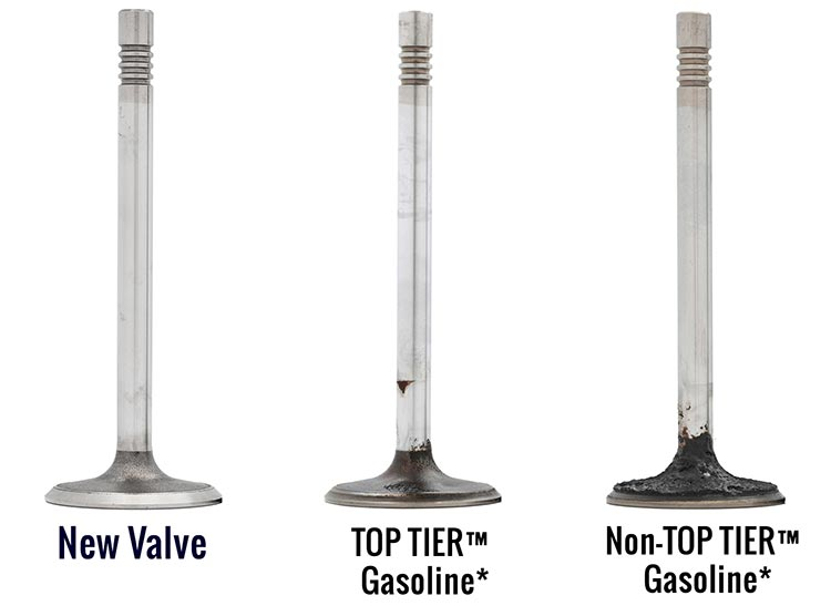

As long as we're talking about gas, Top Tier Gasoline actually is better for engines since it contains more detergent additives than the required federal minimums. Nowadays most major name brands are Top Tier anyway, but plenty of off-brands, grocery store brands etc. aren't.
The extra detergents can help keep things from getting gummed up, especially if you still have the old central sequential fuel injection setup. The difference in price is usually pretty negligible too in my experience, but it might depend on location.
Consumer Reports: Study Shows Top Tier Gasoline Worth the Extra Price
List of Top Tier brands: https://www.toptiergas.com/licensed-brands/
