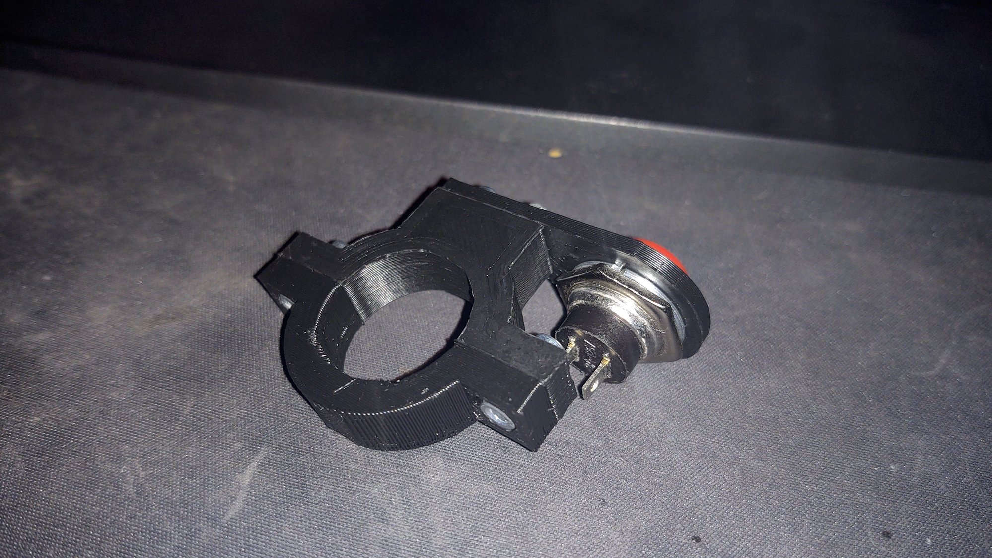

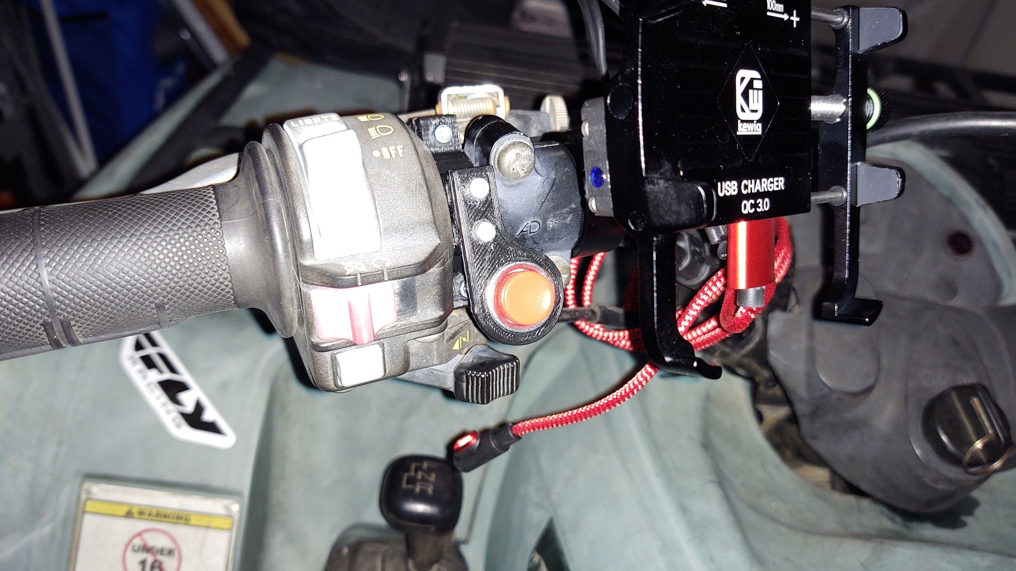

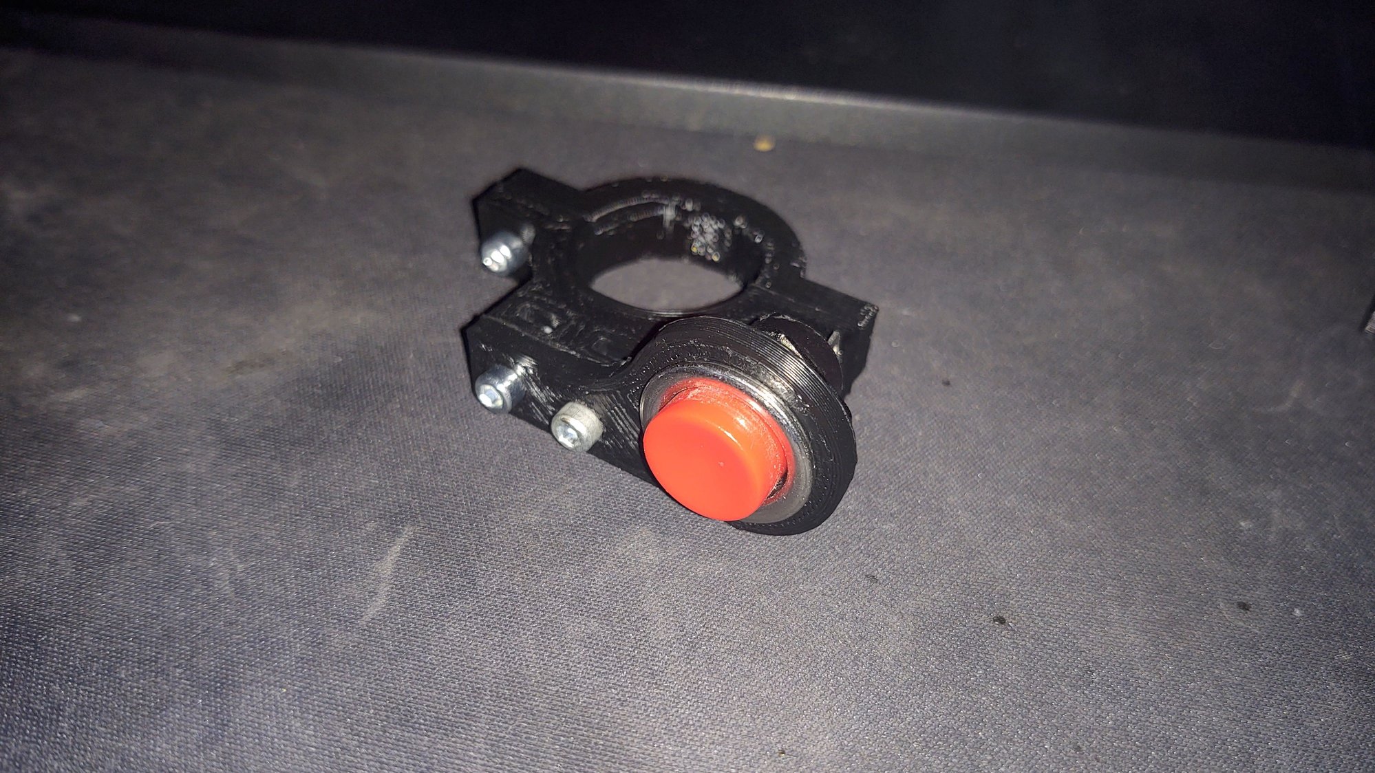

Another small 3D modeling and printing job. Designed a universal bracket for standard 22mm handlebars that can be used to mount all sorts of things. In this first case, a small tab to mount a horn button on our ATV's
I like projects like this. Small, simple, and quick to design and print, yet almost limitless applications!

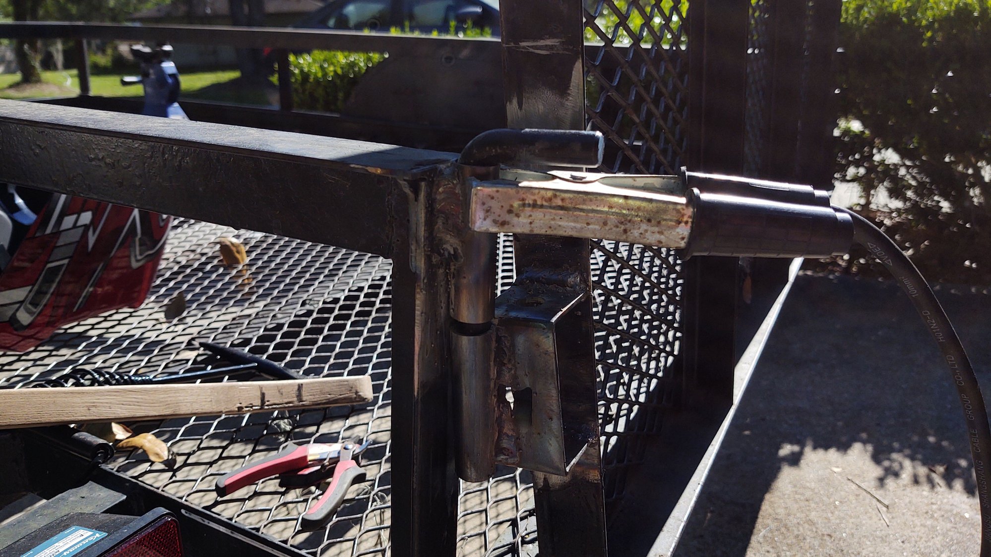

Got outside yesterday and modified the latches on a cheap Tractor Supply trailer. Got rid of the spring loaded sideways latches and welded on some custom made regular drop-in-pin style latches. The 6x6 was catching the pins that stay stuck out about 2 inches inward every time it was loaded on the trailer, already has 2 bent wheels because of it... Now nothing sticks out towards the inside of the trailer and the 6x6 can be driven right up onto it with ease Can't fold the gate back inwards when the trailer is empty any more, but never did that anyhow...
Welds aren't pretty by any stretch, but the 'ol Harbor Freight flux core mig welder does great for jobs like this. Did even better after I finally ran out of .030 wire and changed it to .035 after this photo, that I took after running out of .030 lol

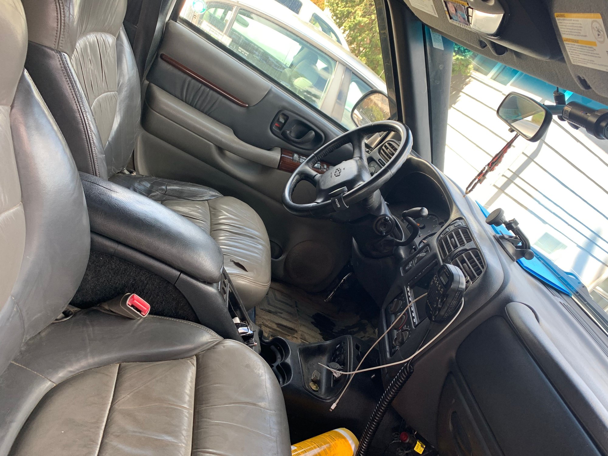

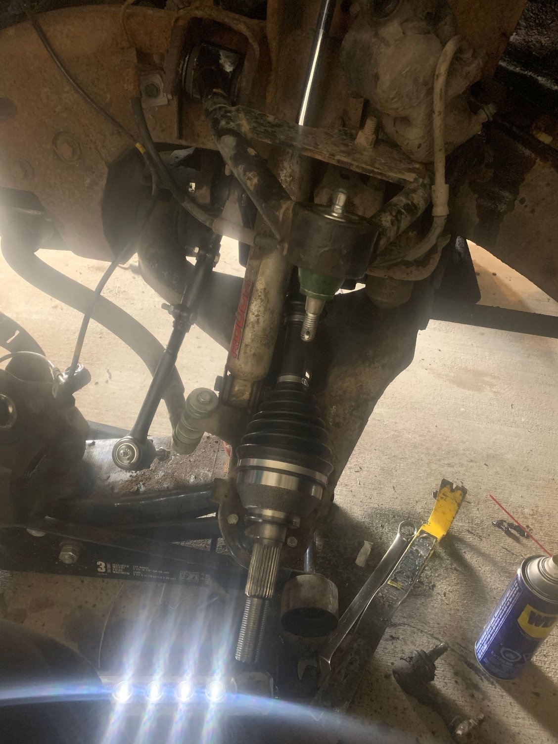

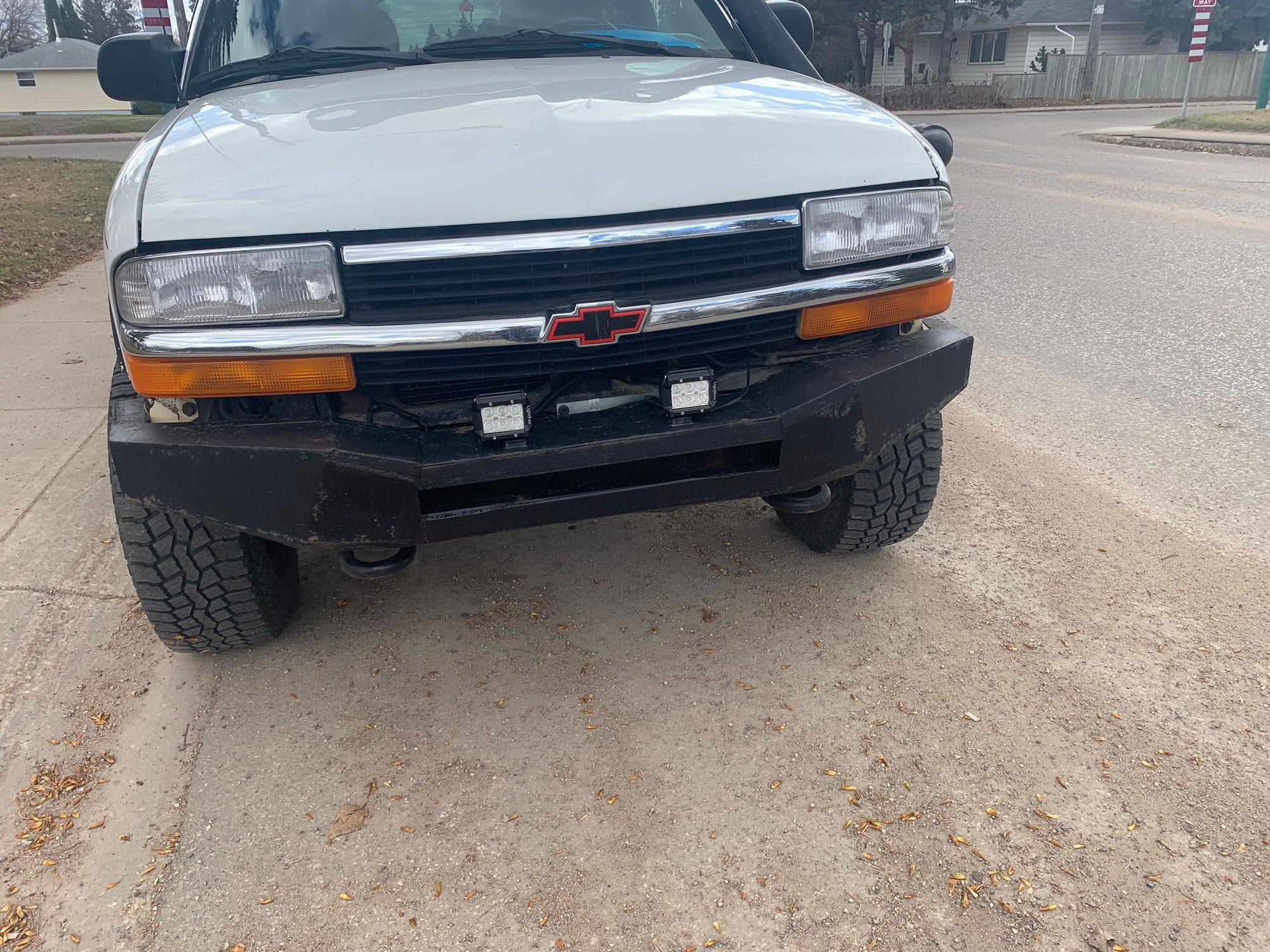

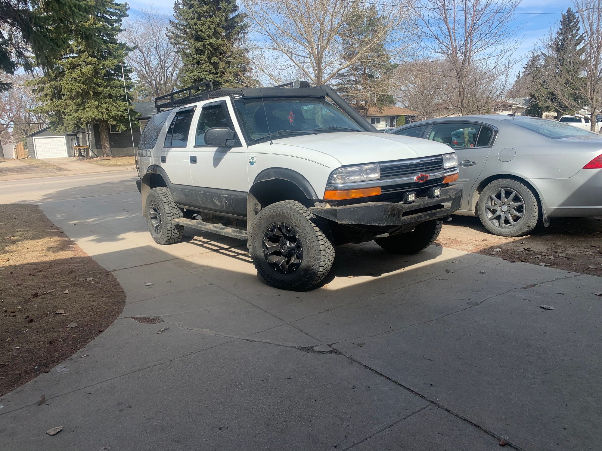

Omg been doing so much stuff rebuilt my front bumper, installed a pa 2” body lift, new fuel rims, new ball joints, cv axles, tie rods and sleeves. Lucked out and found a 99 envoy at the wreckers so got heated leather seats and door panels with the ash tray delete and deluxe overhead console only thing left to put on is the ash tray delete and overhead consol
