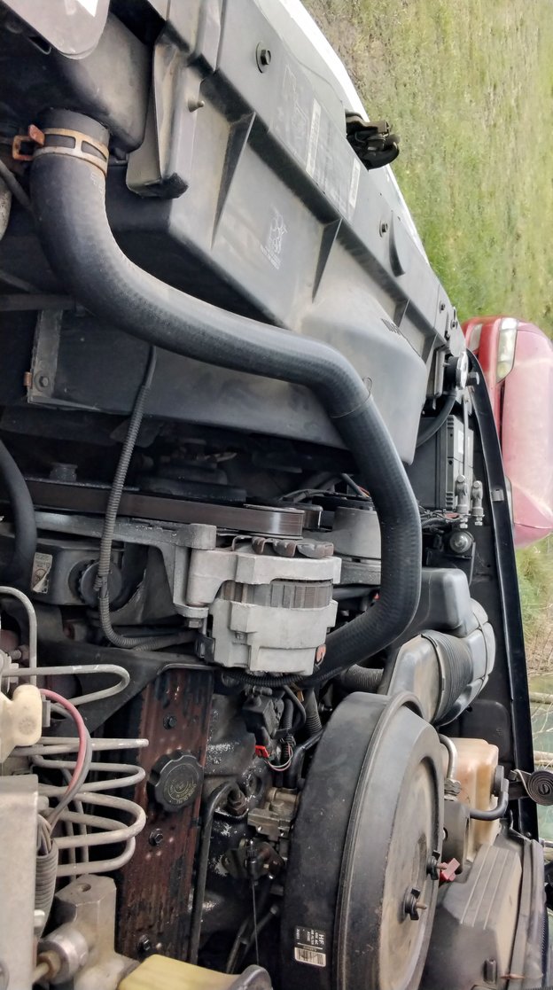

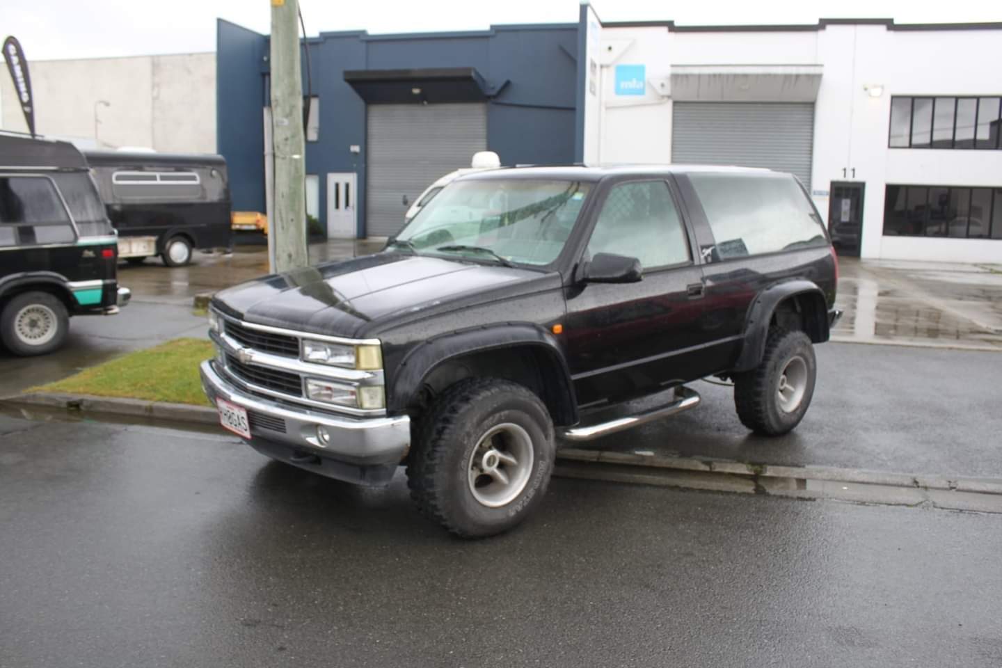

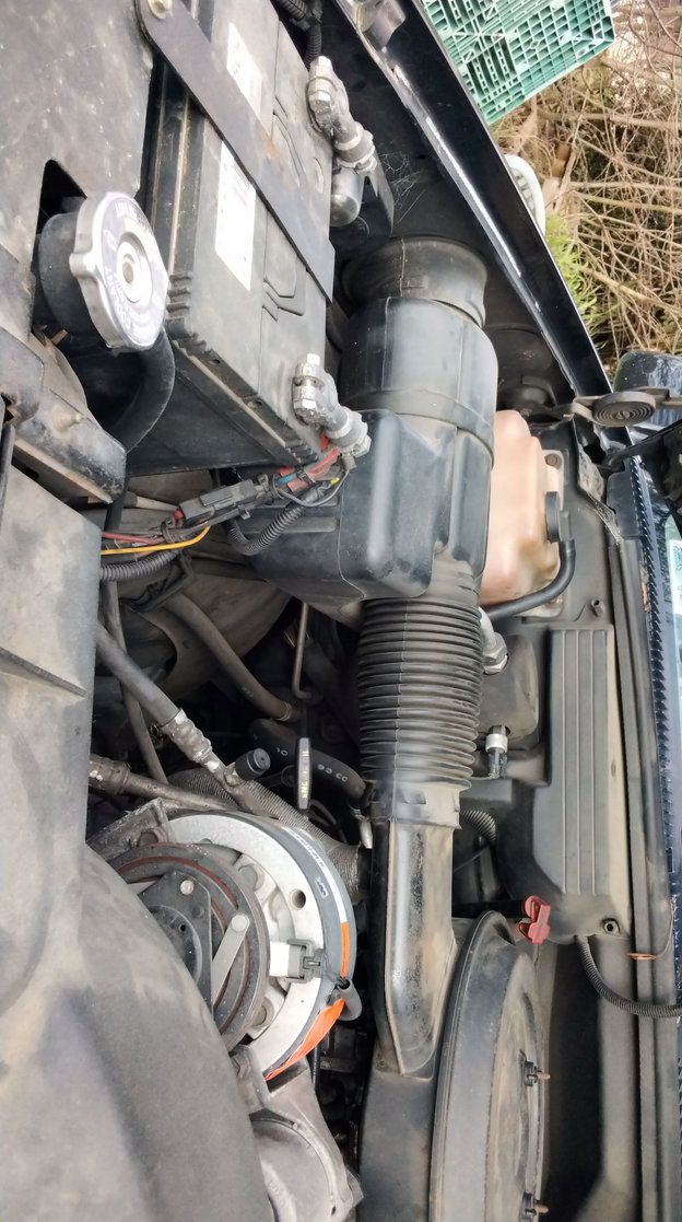

Hi Everyone, Thanks for letting me join this forum I've owned this truck for almost 3 & 1/2 years now, she's a bit of a tank but I love it!! It was imported via Japan so I am the first NZ Owner. Im still learning about whats under the hood and im wondering if anyone can help me out please with a couple of questions as I am working on an experiment. First of all, does this vehicle have an ECU or MAF Sensor? Secondly, I've located the OBD port under the steering column which is 12pin, can I fit an adaptor to this to make it OBD2 16pin? I know Vehicles from 1996 onwards were required by law to have OBD2s And lastly, where do I find the air intake please? Cheers🤩

Welcome to the forum. Your Blazer does not have a MAF (mass airflow sensor), but it does have an ECU (engine or electronic control unit). The OBD1 system cannot be converted to OBD2. I'm not sure what you're asking about the air intake. If you want to know what part it is on your engine, it's that big round thing on top with the fat hose attached. If you're looking for an aftermarket one, I don't know where you'd find one or why you would want to. The stock one is actually very good.

Good morning Tom, thanks very much for your info, apprecite it🤩 I'll be keeping that big round thing with the flat hose lol so where is before the air intake? I need to insert a 1/4 inch pneumatic hose before the air intake to deliver gas also where would I find the ECU? Cheers, Berta

Are you talking about injecting gasoline, or a gas, like nitrous oxide? The inlet for the air is inside the fender, but you should be able to make a hole anywhere in the duct before the air filter to inject a gas. the seal between the plastic duct and the metal air filter housing is not airtight, so it would probably be best to do it in the metal part of the duct, after the plastic. If you're talking about injecting gasoline, you can't do it that way. You would need something more complicated.
