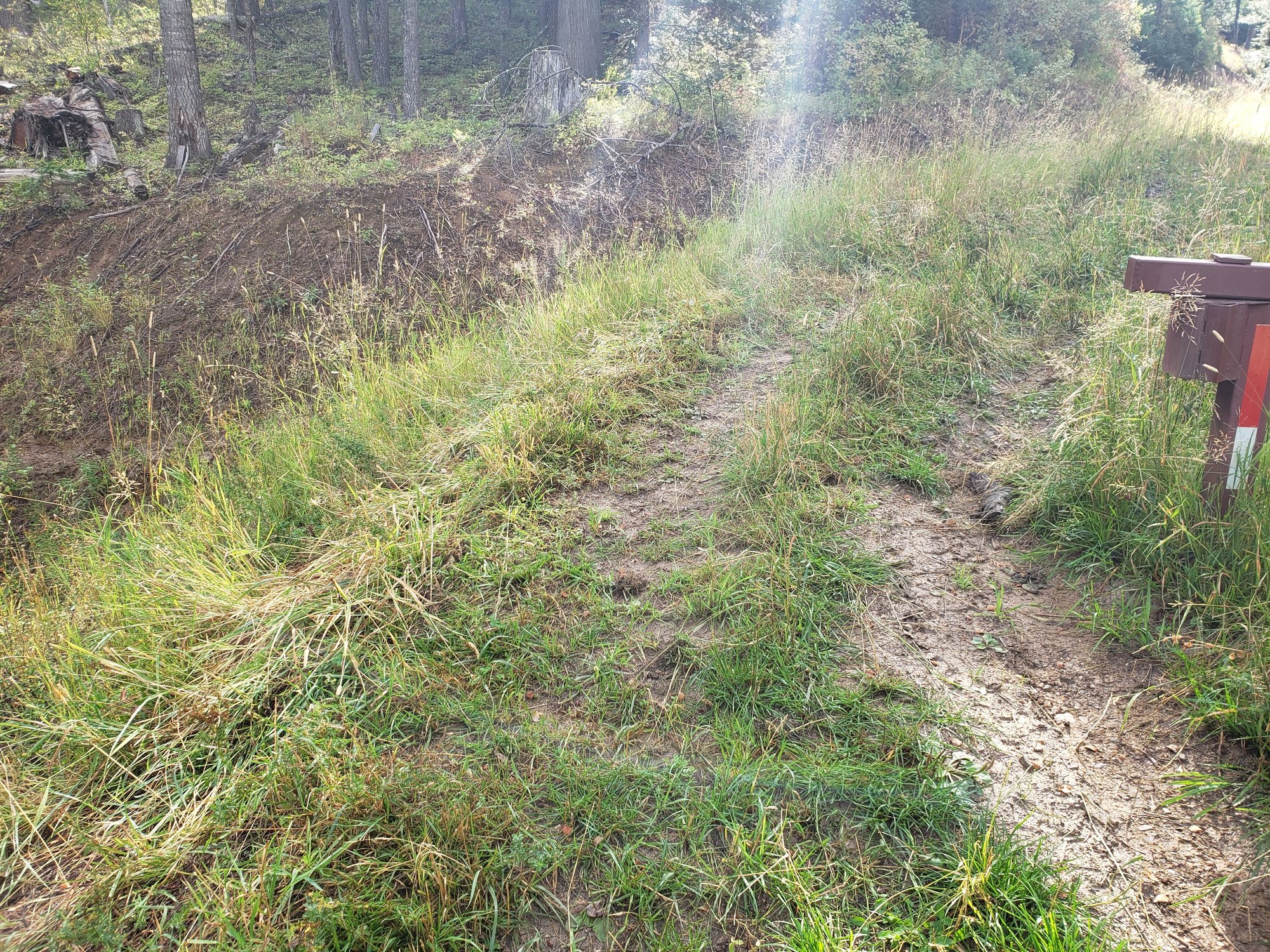

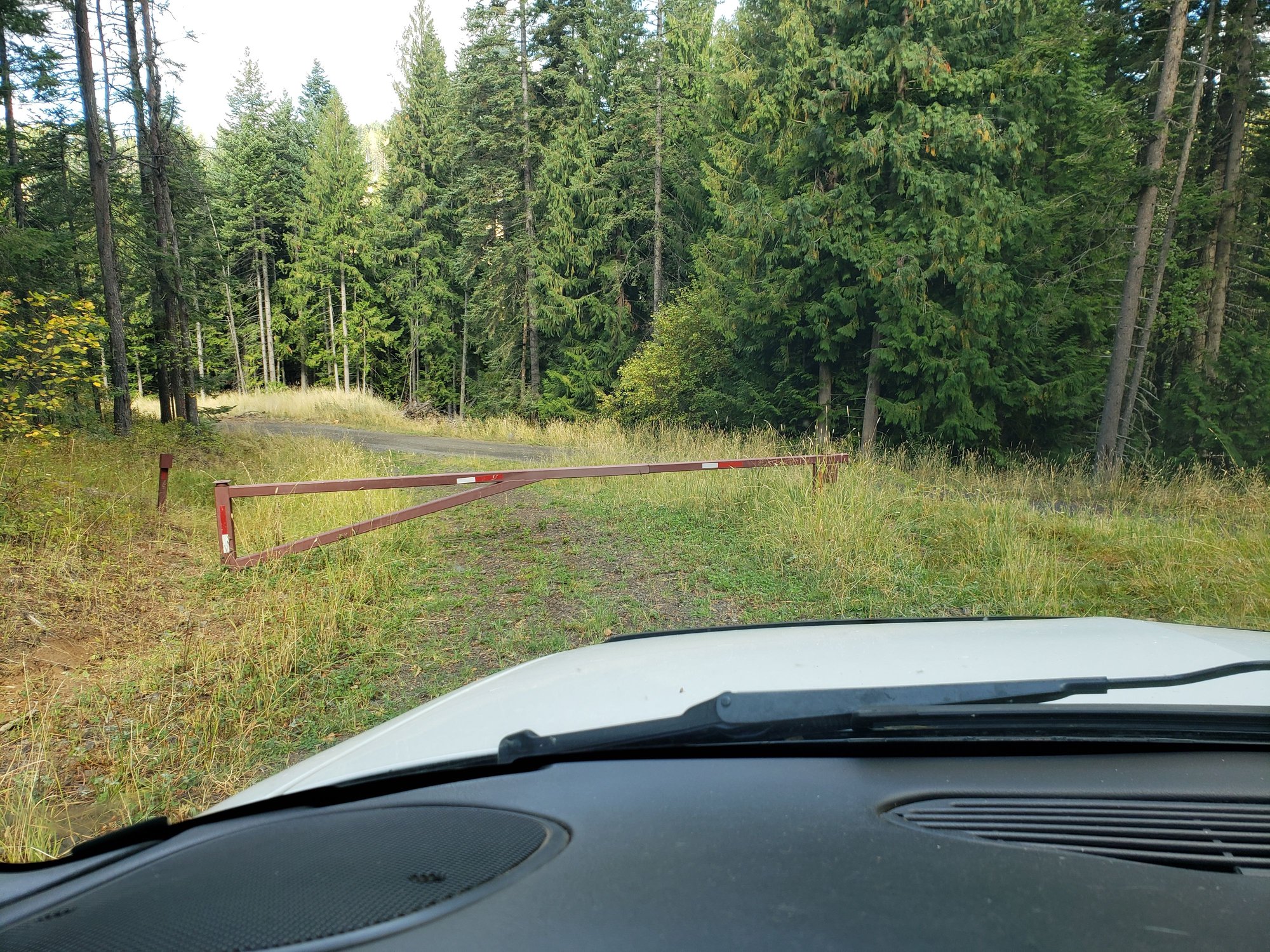

Uh oh! I'm on the wrong side of the gate!
Now on the right side of the gate. Whew! BTW it was a steep drop-off for the road-cut on the left that is partly hidden by the tall grass.
