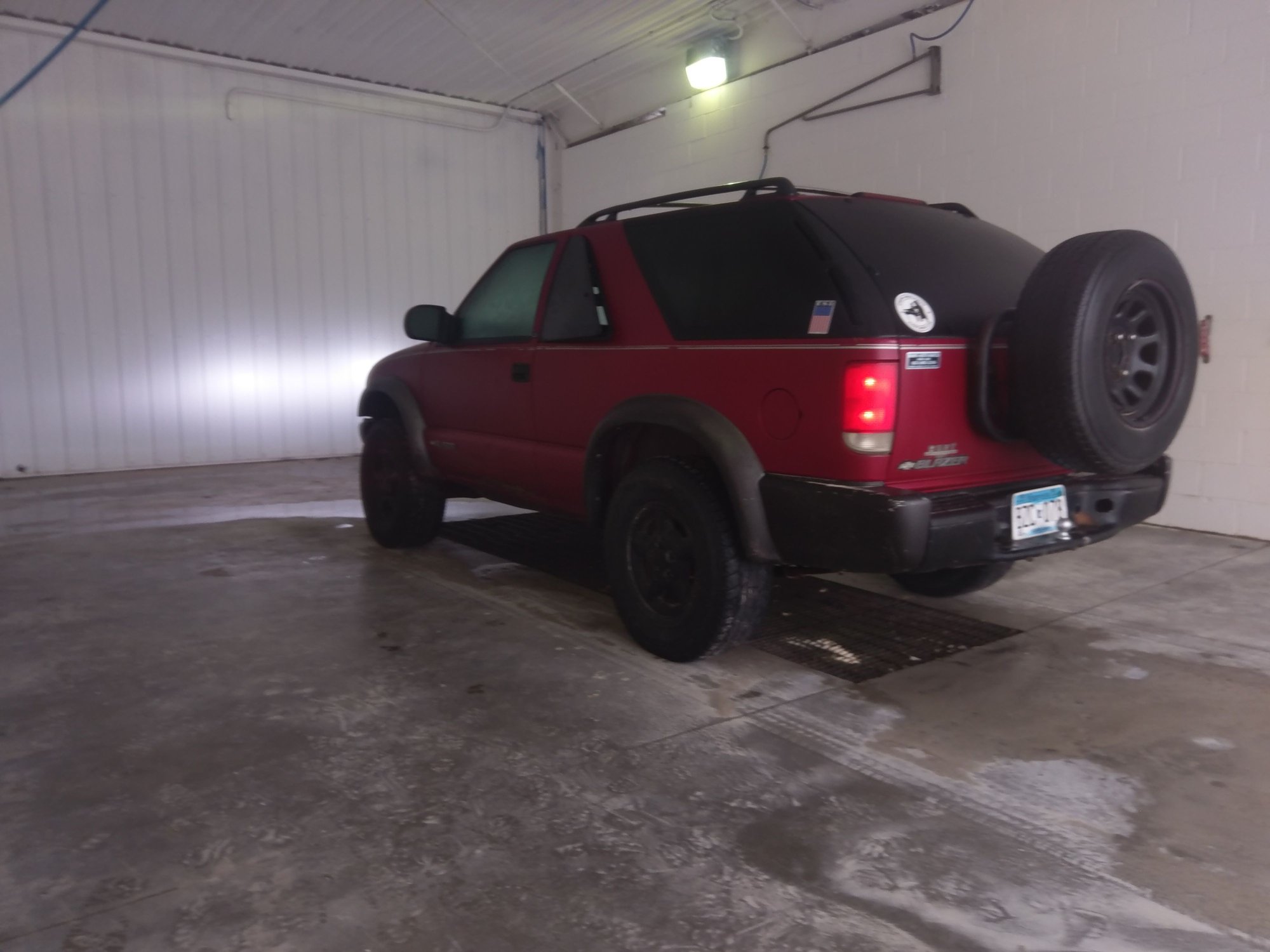

Brainstorming my build I have a 99 blazer 2 door ls that came from Colorado 190,000 miles I've got my money saved up and want to fully rebuild the 4.3 to handle more power new intake manifold and going with a fuel rail rear mounting two turbos to the rear bumper and thinking about an astro van drivetrain possibly a front diff off an olds bravada, any and all ideas are welcome and any advice to get this blazer screaming down the track I will be all about thanks
https://cimg2.ibsrv.net/gimg/blazerf...de7f76b2f0.jpg
Twin turbos under spare tire on bumper
https://cimg4.ibsrv.net/gimg/blazerf...c4d47f43f2.jpg

If you're planning on spending the money and doing the work to remote mount twin turbos, why no just ls swap it, and be done?

well just about everyone ls swaps I want to see what I can get this 4.3 to do I'm not aware of another built 4.3 blazer with rear twin turbos can't a guy be different lol
