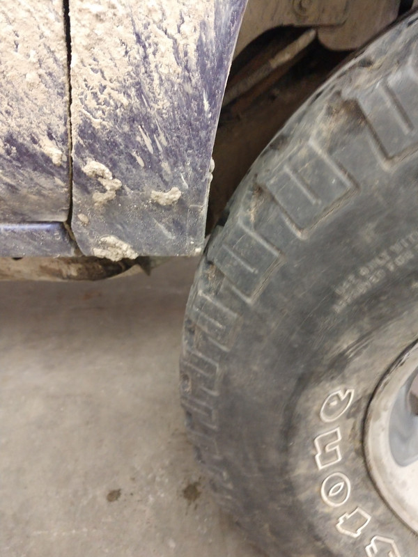

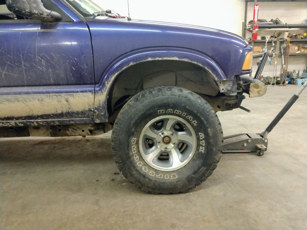

Here is my 96 Jimmy, 2" body, after market keys and rear shackles. 7" wide 2wd rim with 33/12.5 test fit. It clears but will touch the fender before full lock. I'm going to trim the fenders and may have to crank the torsion bars more. May switch to 3" body lift.
