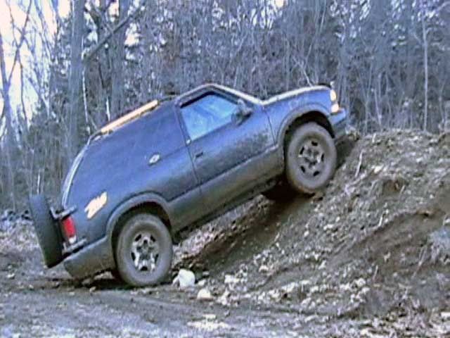

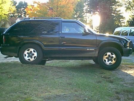

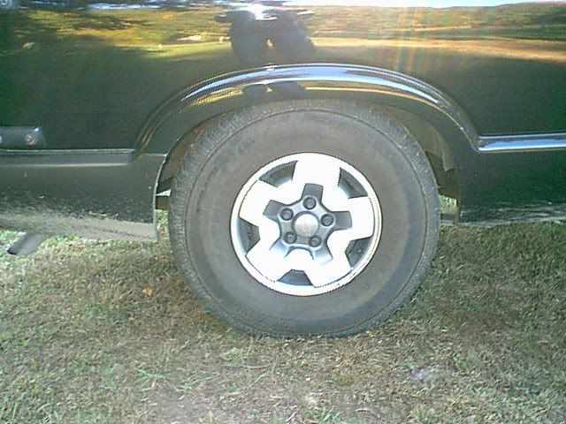

Sledneck rubs 'cus he has rims with a ridiculously low amount of backspacing. Those diamondbacks are something like 15x8 with 3.75" of backspacing, which stick out 3.25" more than stock on each side. If he had stock rims, he'd be fine.
That chart doesn't even have a listing to S-10 blazers, so I fail to see how it applies?
Stock Blazer on 31's:
again:
again:
plenty of room:

the top pic appears to have a ZR2 tag on the blazer... 31's are stock on a ZR2... and the flexed pics obviously show that the tires are almost completely bottomoed out in the wheel wells.... you couldnt turn those tires without them rubbing...
sledneck tried the 31's on with his stock rims once judging by his previous posts..... if 33's wont fit on a silverado without 5" added, they wont fit on a blazer.... thats how the chart applies.... the irritating part is that you are telling a guy (with a legit question...) that something will work on his blazer..... it wont work in all applications... maybe your brothers truck is different than all of the other blazers produced, or maybe he doesnt take it off road... the fact of the matter is, to fit 33's on a non-zr2 blazer you have to have a minimum of 5-6 inches suspension to have absolutely 100% no clearance issues....

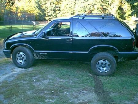

Take a look again, it's not a ZR2. No flares, no widened stance, the sticker reads "ZM6" The ZR2 package is more than a sticker. That was my last truck, it didn't rub unless you jumped it. It may look like it 'cus of the angle of the camera, but it's not even close to rubbing.
I don't doubt that you need close to 5" of lift to fit 33's, i never said you didn't. My reply saying that you shouldn't need much more than he has (which is 3" over stock in the front) was to the guy who said you'd need a 6" lift and a 2" lift.
Believe what you guys want. It's your trucks.
BTW, this is a ZR2 (in case you need an example)
