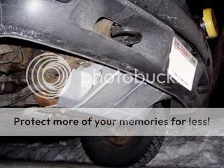

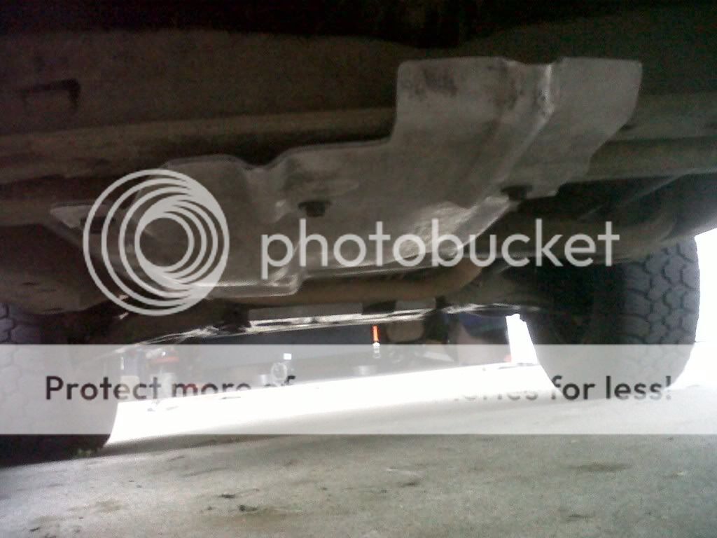

Originally Posted by 97cherryblazer
i worry about taking my blazer off roading because it has no skid plates accept one tiny one under the trany. it has a guard under the engine but its plastic and a guard around the gas tank but its also plastic. my blazer is a 97 Lt are they all like this? or are these plastic guards strong enough to protect from most debris?
Unfortunatly most are like that. What you have to do is find skid plates from an older blazer/s10 or one that came with them. Thats what I did. They come in aluminum and carbon fiber.
Here's mine.
Here's mine.
Thanks for the pics! How hard was it to get that in there?
Do you mean put them on? They just bolted right up, You have to get mounting tabs for the front diff skid plate and my t-case skid plate needed some trimming to fit.(I guess the auto track t-cases are deeper than the regular ones)
