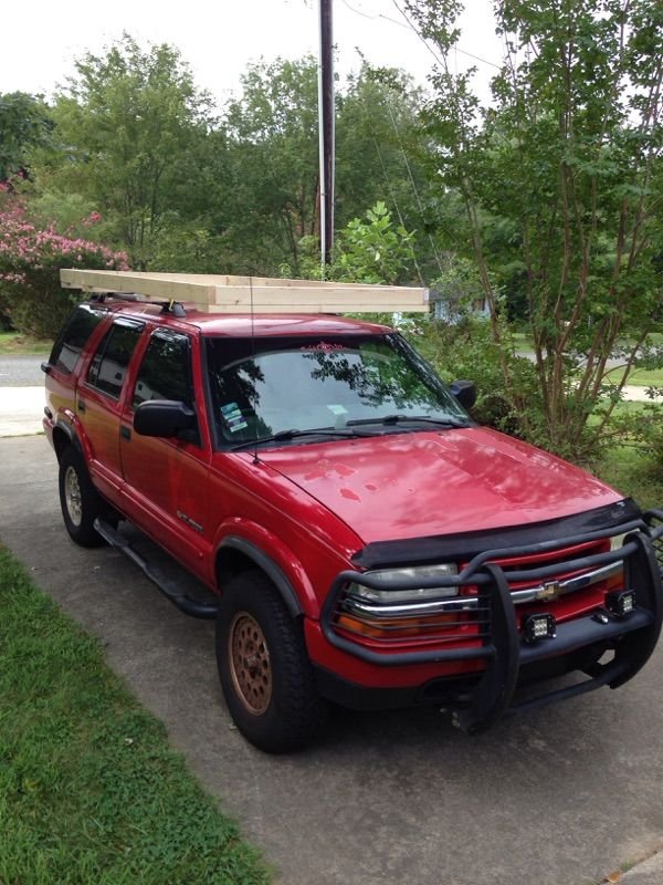

I do. I've had them for about 5 years and they've held up well. They look okay but they don't look nearly as nice as actual Blazer fender flares like what Jungle Makes. Especially if your tires are stock sized with the stock track width. The Pacer flares are really just a way to make vehicles with wide offset tires legal to drive in states that require the vehicle's fender to cover the tire.
Having said that, I have the 1 3/4" option and unless your track width is wider than stock, I say stick with those. I've seen the 2 1/2" option and they really stick far out of the fender. They were on a lifted Ford Ranger with gigantic mud tires that were sticking outside of the fender by about 4" so they actually looked pretty good on it but they would look silly on a stock blazer.
Also, the wire isn't needed. It's pretty tough to stick into the flare and by pretty tough, I mean I got like 4" in and gave up. And whenever you get it installed, the flares are plenty stiff enough by themselves. Just use all of the screws that come with it.
Here's some pics to check out.

Harry thank you so much for the info and pictures, seeing them installed on one of our trucks it's really a lot of help man I truly appreciate it. Don, if you need somebody to help you out and get them things for you just let me know. On vacation from work till the 15th, guess i am gonna go ahead and see if I can get the jungles installed. I don't know though, I'm telling you I think I'm going to have problems, I don't know if I'm going to like them and if I don't who knows, them other ones might be an option; I'll let you guys know in a day or two. We had wnow on halloween, a dusting this morn, gonna bring em in the house so they can warm up an loosen up a bit, rite now the fiberglass is so tight; almost brittle. I picked up some sms with rubber backed washers from fastenall 2day and some 3m tape from a bud who wrenches and does body work at a local shop that he "donated" to me. They are already primered and the edging glued on. I know the fronts are gonna be a bitch; the rears (over tire pieces) shouldnt be to bad, and i still havent quite figured out what i'm gonna do about the pieces that go on the rear doors. FUN FUN FUN! It is supposed to be 50 degrees tmrw ( my bday also) only warm day in the forecast.
