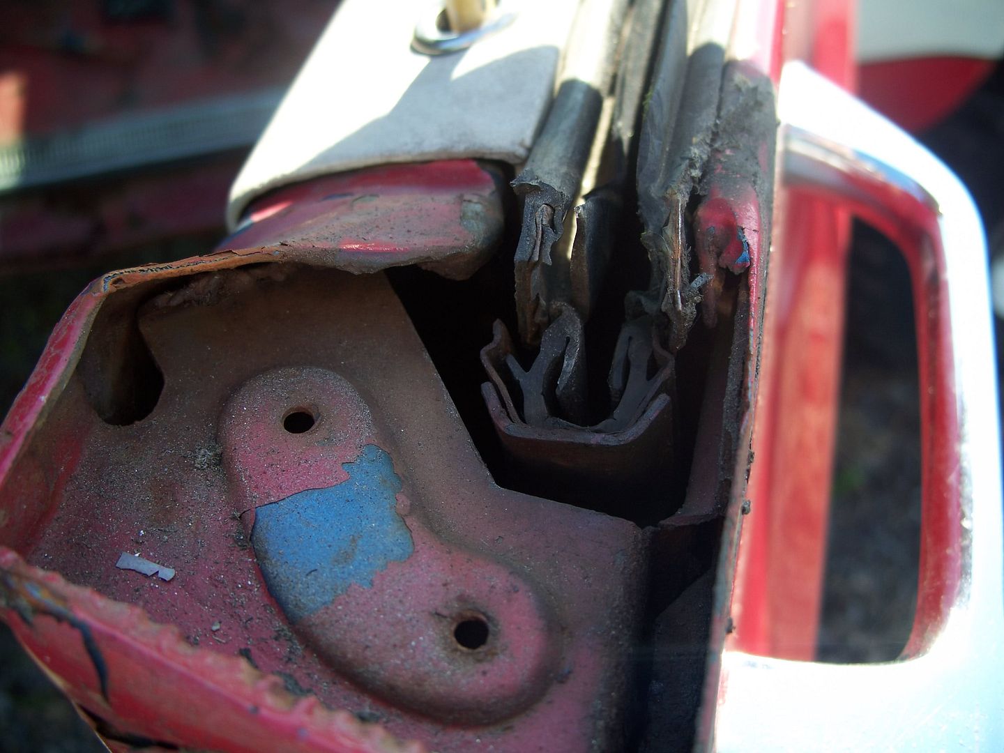

You have to cut down the full frame doors to work. Add in the few reinforcing brackets used and drill some extra holes. I'll be doing this with my '90 Suburban doors for use on my '74. I will be picking up another '74 for parts and using the brackets from those doors so I do not have to be door-less during this time. The first bracket is under the plate on top of the rear of the door. It is what the plate screws down to. Then the other bracket is on the rear window track. You have to cut down the rear window track from a full frame door, remove it's bracket, then add the bracket from the convertible door.
I have already had to do the conversion of the rear window track on my passenger door as I had my rear window track break and just happened to have a full frame rear window track on the bench in my garage... I did not take any pictures though.

Just to put some pictures in this thread and refresh it in my subscriptions...
Here are some pictures of the stock doors and the parts I was talking about:
