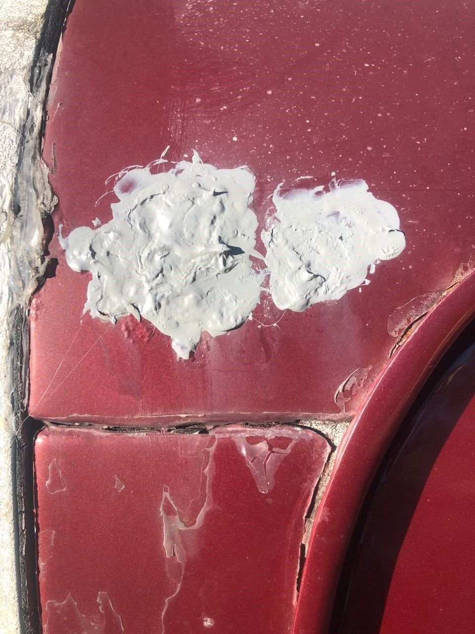

hi
the rust holes are located on both sides of the roof at the top behind the door towards the topper and reaching the factory seam of the small body panel coming up from the quarter
im trying to get a pic so you can see the size, the holes are not in the door jam area just on the flat curved part of the roof.

Old Dec 3, 2019 | 01:56 PM
Let me know. If the pieces are small enough to fit in a flat rate box and I can cut them out easily enough, it shouldn't be a big deal.

heres a pic same on both sides
Old Dec 3, 2019 | 02:09 PM
Just the outer skin? Does the rust go down to where the bolt holes are?
Too bad you're not local. I would just give you the whole roof.

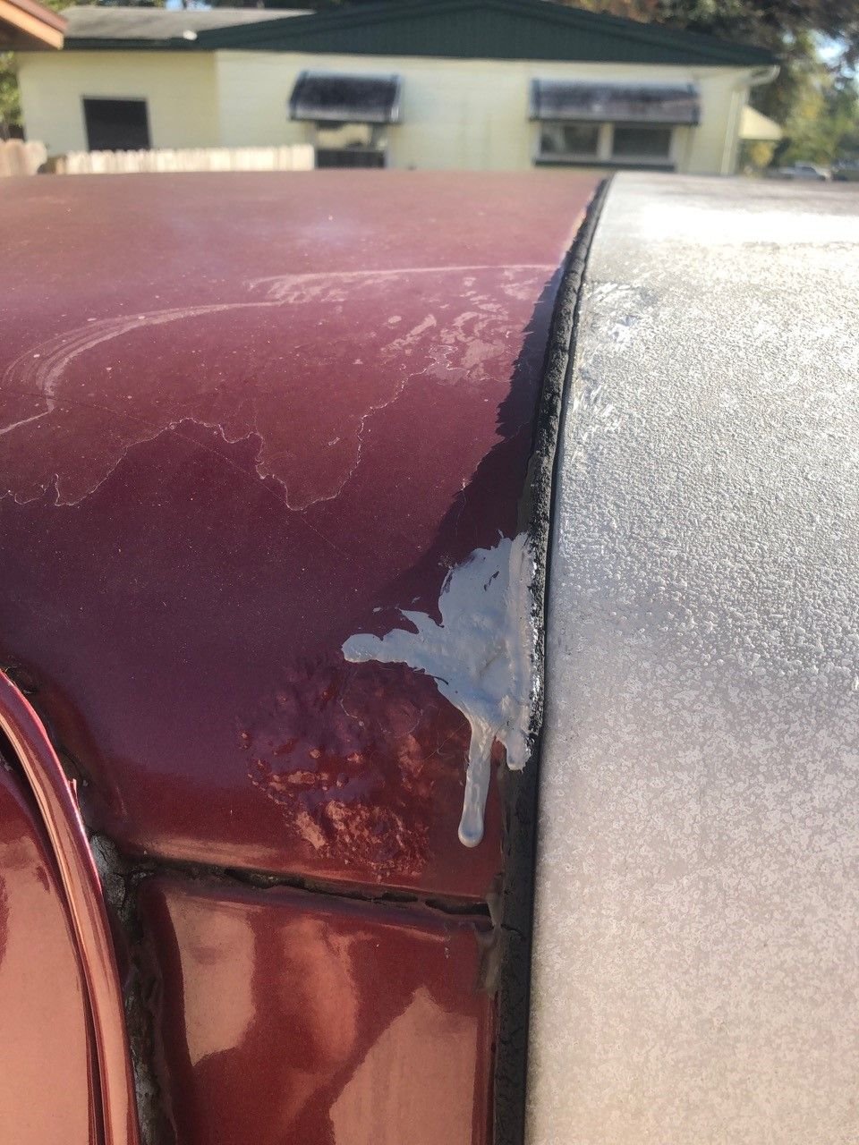

here is the other side
