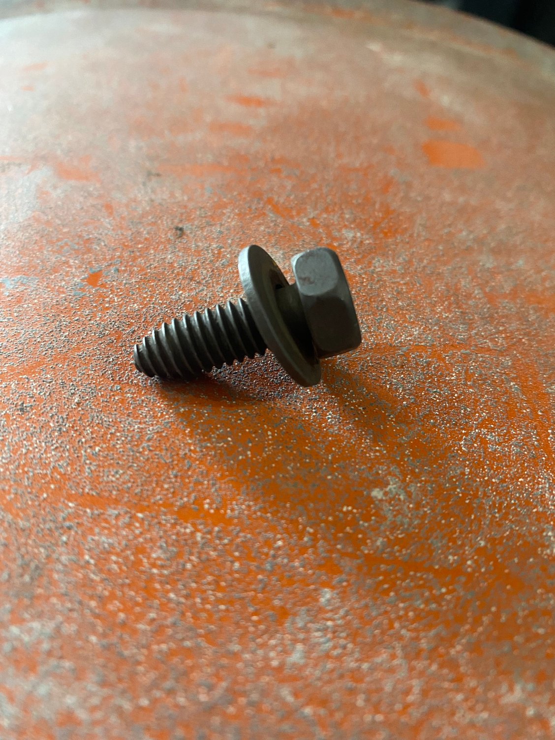

I think they're 5/16-18 by 3/4 or maybe an inch. Do they take a 1/2" wrench? They might also be metric. If you can post a picture of the head markings, we can tell you.
Also, they are specifically body screws. That's what you need to order if you want the tapered threads.
