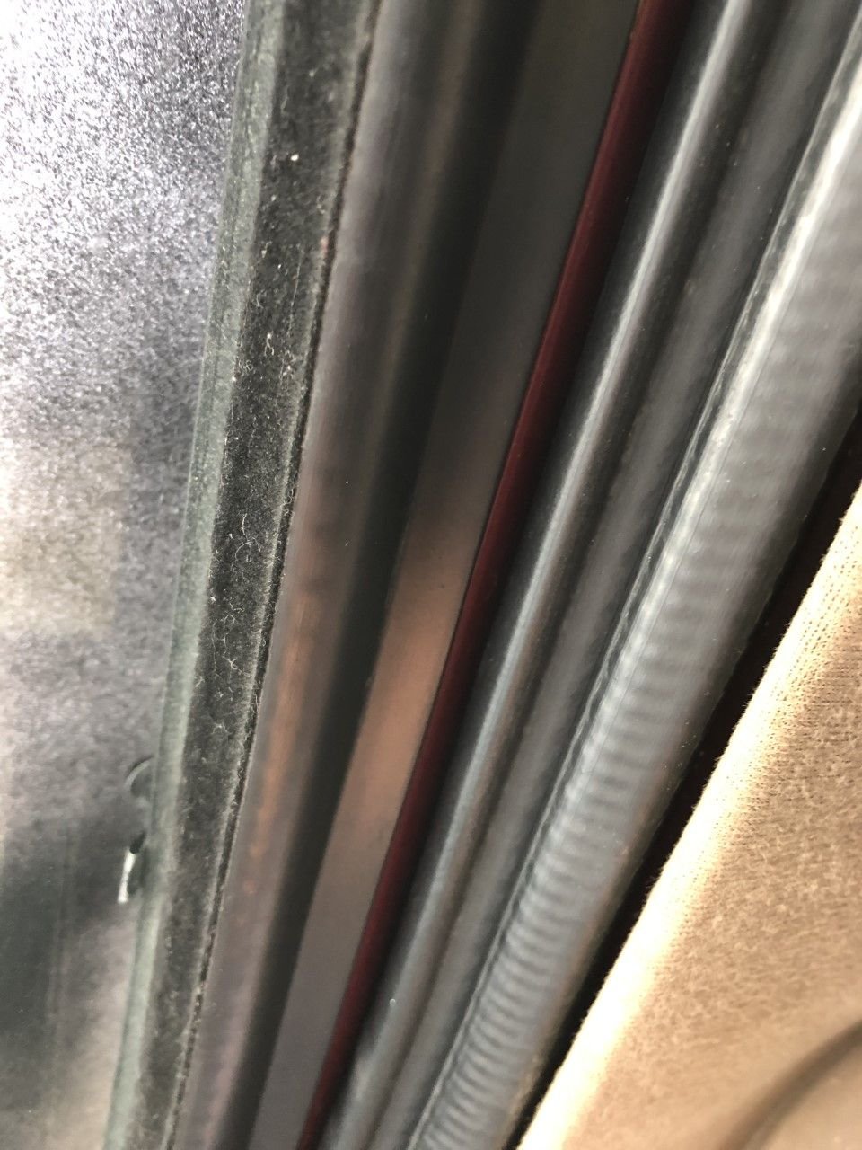

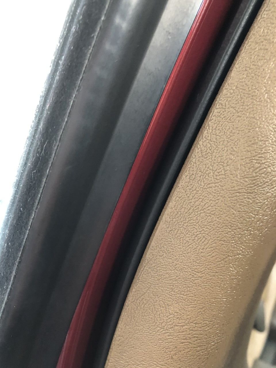

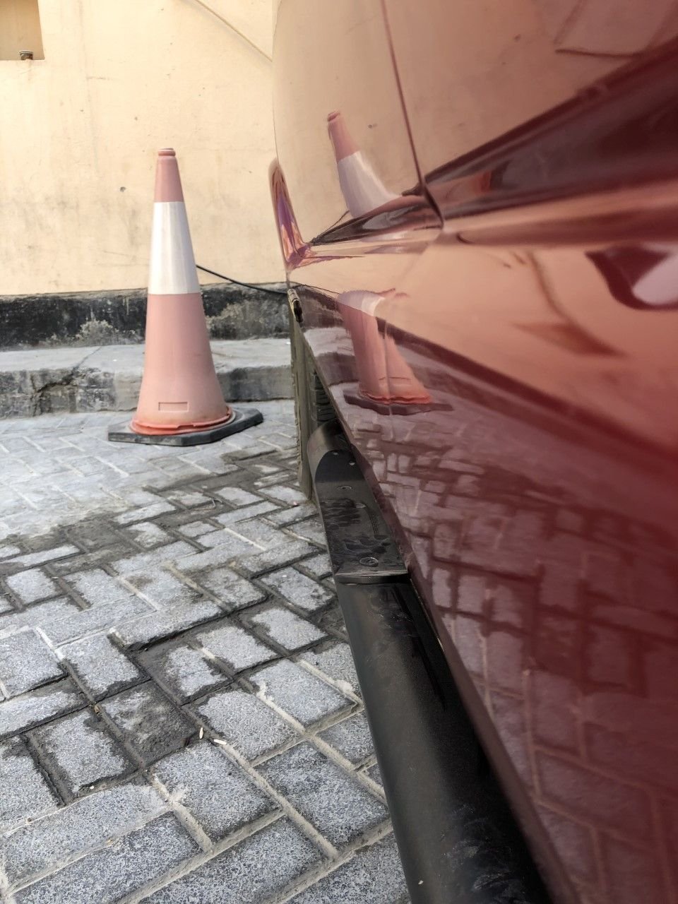

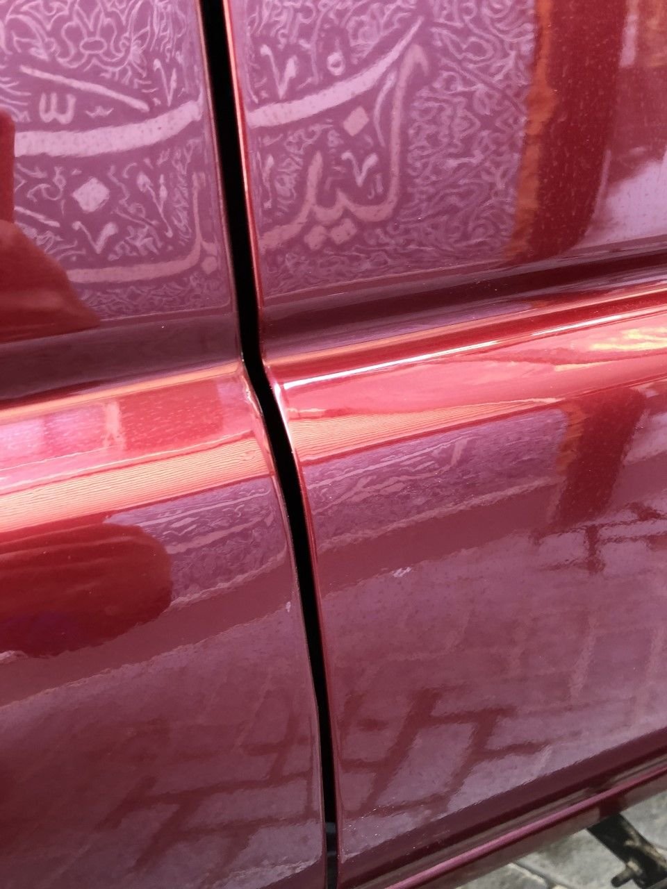

jimmy_for_ever Dec 31, 2020 10:50 AM
Today,I take a bulk of photo for my car both front doors (The leak only in driver door )
Here are the photos:

christine_208 Dec 31, 2020 01:09 PM
Hmmm. I think it looks like you have all the seals you should have.
What is the condition of the hinges? The lock and strike plate? Perhaps it is the door that is not aligned and drooping. Do you have to lift it at all to get it to close? If so the hinges could be bad and the lock mechanism could have been damaged.
If it is the door hinge, you might fix it with a set of new bushings. What makes me think that it might not be the hinge or at least only the hinge is that it appears that you have a gap where the rear of the door meets the pillar. This prompted me to suggest that there could be an issue with the lock too.

jimmy_for_ever Jan 1, 2021 01:50 AM
All the bushings include pin and spring roller pin are new So, I don't think this problem can be from them.
