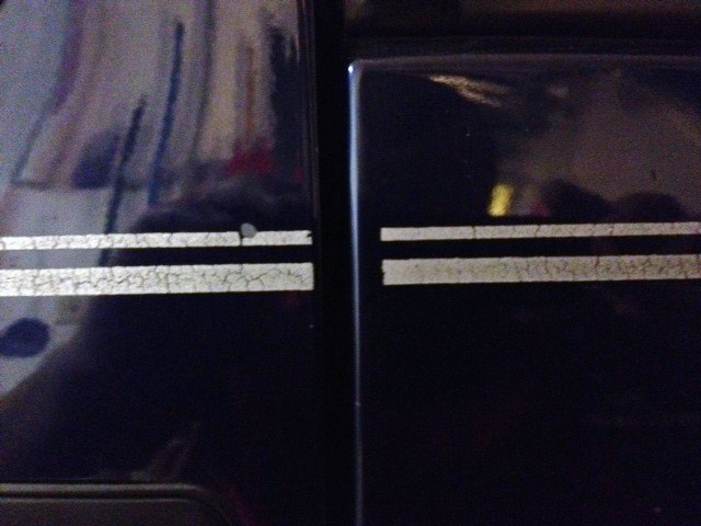

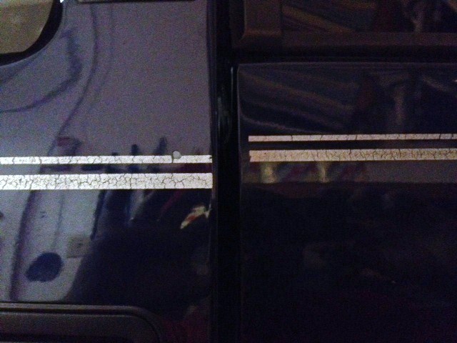

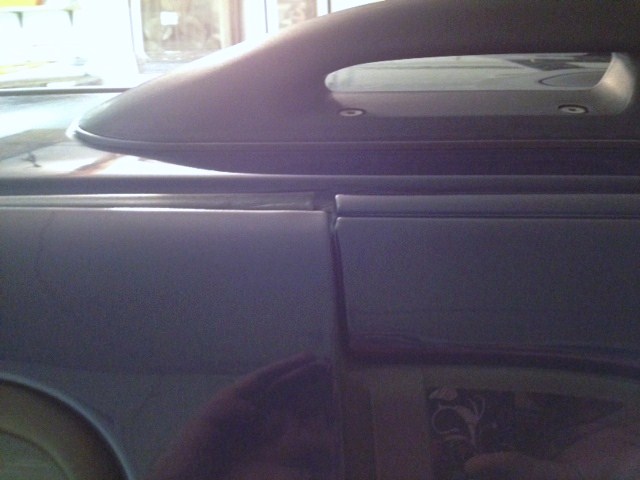

Well all I can say is holy crap. The pictures tell the story, especially the pinstripe. I didn't realize how bad mine was.
It actually took me about 40 minutes to figure it out and it was mainly trying to get the thing in correctly and trying to figure out which one the truck needed. Turned out to be the third smallest. I kept thinking they sent me the wrong ones but with a little persuasion with the hammer it went into place. You will have no doubt when it goes into place correctly to bend the tab. I tried the one up and the one down from the one I ended using. Once I knew what I was doing it is a less than 5 minute repair.
It does still have a little wind noise (much much better now) but I think if I adjust the striker to pull the door in a little more it will be eliminated.
If I didn't know it was installed could I tell the difference between it or a door without elongated bushing holes (factory new)?
No
Would I do it again?
Heck yes unless new bushings and pins would fix it and in my case they didn't. Wish I would have known about this before I replaced bushing and pins.
Would I recommend it?
Heck yes. I can see no ill effects using this to repair the door. Well worth $25
