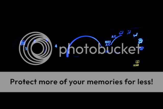

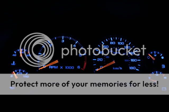

194 inverted V-LED's in the guage cluster... #37 inverted V-LED's in the HVAC, pre-wired 12volt LED's with resistor, ready to connect.
Looks like:
I've since made the 4x4 buttons brighter by repositioning the LED's in the module
If you figure out a way to solve the hot spot issues... lemme know... I think my camera metering was off for the shot of the light controls... it's alot brighter in person.

Took 6 194's, and 4#37's
There's more lights I'm going to replace in the dash and reposition some LED's to get a better spread. And yeah, there's a story behind those fuzzy dice on the dash lmao.
