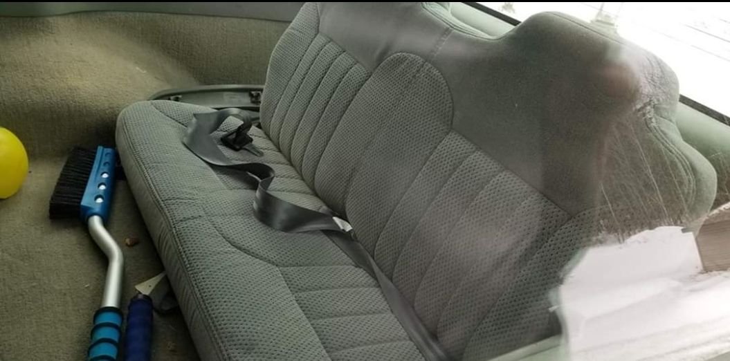

So a third row seat was actually an option on 2nd gens..... to residents of Europe.
Saw one, a 96, guy imported... think he was stationed in the military across the pond.
3rd row seat was only for kids, pretty much... think it had a 60 lbs limit.

My bad, it was a 95.
Here's a pic, since I couldn't find anything on Google.
