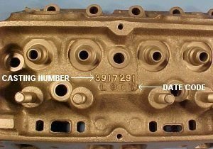

OK - lets figure out exactly what you have. Need number on pad on block at front of passenger side head. This should be right behind the alternator and is visible from above. Then pull the passenger valve cover off and read the numbers cast into the metal. Finally take a photo of the top side of your engine and post it. This is the only way to know if this cam is appropriate for your engine without further mods. Comp 270H is an old-school single pattern cam of moderate duration/lift with a 110°LCA and 106° intake centerline. Decent street cam in it's day with a little lope in the idle, and it's appropriately sized for a 350 on the street - but it's not going to play well with fuel injection or with poor heads/stock intake/stock exhaust.
Of most importance is the ID of the heads. If it has original swirl port TBI heads on it (such as casting code 193 suffix), a Comp 270H is completely inappropriate as these heads have horrible performance and will give up by the RPM where the cam should start working. These heads have center bolt valve covers.
