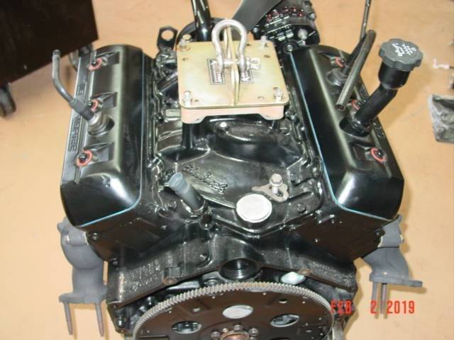

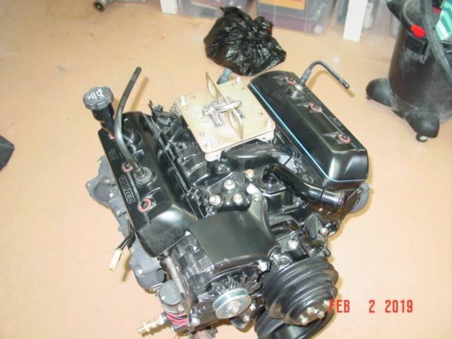

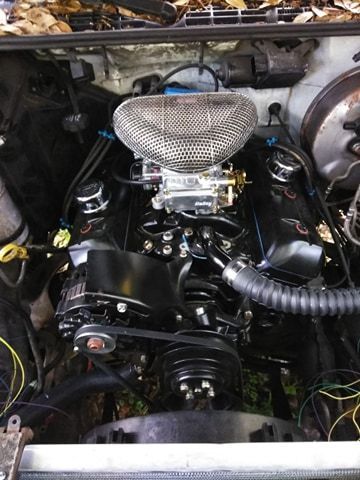

The new motor is set up to run on a carb as in it has an Edelbrock intake with a 4100 Holley four barrel flange. I want to eliminate all the computer crap, can't I just run fuel and spark and make it work? Obviously the gauges will need to be addressed, but what is the need for the computer if there is no electronic injection going on?

Here are some pictures for reference:

Basically this is a bad a$$ motor that I found by total chance at the exact right moment. The guy who built it has been building race motors for about 50 years and he is now retiring and closing up shop. This was his personal motor for his rat rod, he did all the machining himself, its a complete fresh motor; new bearings, roller lifters, new pistons, fresh cylinder walls (.030" over), timing set, cam...everything internally is new, balanced, and assembled by a life long, old school gear head. I couldn't pass up the opportunity to have something like this in my Blazer. Not only is the LS swap too costly right now, everyone is doing it. I know this won't make nearly as much power as say a sweet 5.7, but this motor is something you just don't see every day. At least I haven't seen many beefed up 4.3's besides a few on youtube.
