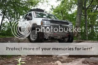

I got my truck 1.5 years ago and planned to keep it stock, well....
Basically stock...
Lifted
silent armors and crappy armor
Deconstructed for more lift
Show and meet ready...

Real Armor...
Used and abused
Clean and ready for more
A couple pics to show the difference from stock to now...
I am having a 9 inch rear and high pinion dan 44 delivered tonight for the next step in building the ultimate Trailblazer. I think it has come a long way in 1.5 years and cant wait for some extra height and strength, plus the ability to get lower gears and lockers, and just maybe some 37's.

Wont gear at first until the suspension is dialed in, but then 5.13 or 5.38 probably. electric or air lockers, well at least front, may just do a conventional locker in rear.

3 inch body and 3 inch suspension front with 2 inch suspension rear. Have springs being delivered today that will give me an extra inch of lift. I have a hybrid suspension with Bilstien HD's up front along with a two piece spacer system. I have BDS long travel rear shocks with a spacer and 2010 z71 Avalanche springs. Also changed panhard bar to recenter rear end.
