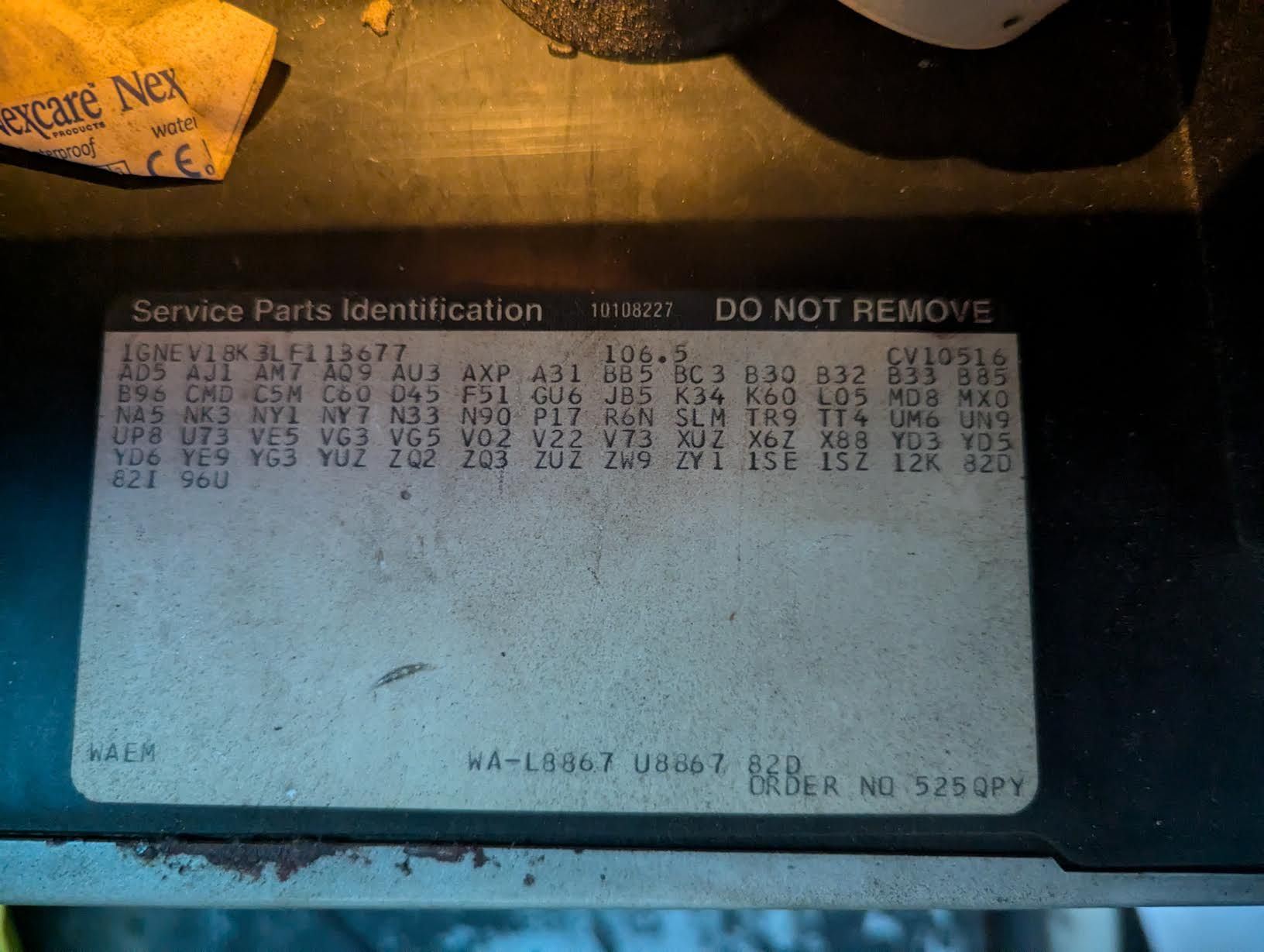

Bought a 1990 k5 blazer 'silverado'? as a project It has the usual rot I have seen worse tho I was not told of course that the rear was blown until I went to put it in 2wd to get if off trailer. I see ther are 3-4 diffrent ratios I am trying to find out what one I have so I can pick up a used rear I have the glove box sticker but dont know what I am looking at any help much appreciated.
Old Nov 1, 2024 | 01:08 PM
Posts: 41,341
RPO Code GU6 that is listed on your SPI label signifies that the truck originally came with a 3.42 gear ratio in the axles. Provided that the VIN on the SPI label matches your truck and no one has swapped the axles or gears, that should be correct.
