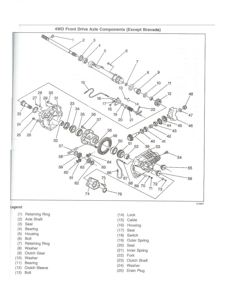

Here is the key clue: ..."hit the 4 HI button and instantly the noise disappears"... The vacuum switch on the transfer case is a known problem. If the O ring seal leaks inside the switch, it will partially engage the clutch (item #12 below) on the right front axle shaft. The noise you're hearing is the gears trying to mesh. If it grinds enough, it will destroy the two gears. When you select 4WD, the switch applies full manifold vacuum to the actuator under the battery tray allowing the gears to fully mesh, and the noise stops, instantly.
The two gears are items #9 & #23:Name:  4X4Frontdifferential-Copy.jpg

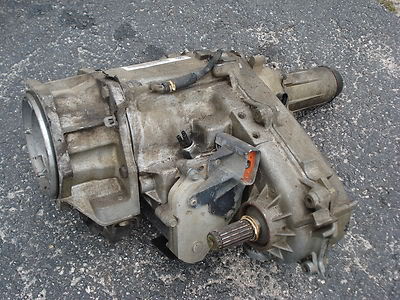

The switch is on the driver side of the transfer case, just above and inboard of the encoder motor, and has 3 vacuum lines connected to it, (about a 15 minute job to replace it).
The GM upgraded part # is: 89059420 and lists for ~$60. Here is a link to the Dorman part, cost is under $20 at most auto parts stores: Dorman Products - 600-500
