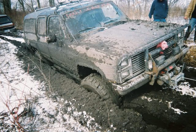

the axles were even on this thing for a while. 82 suburban with 38s and a 400ci engine and survived
