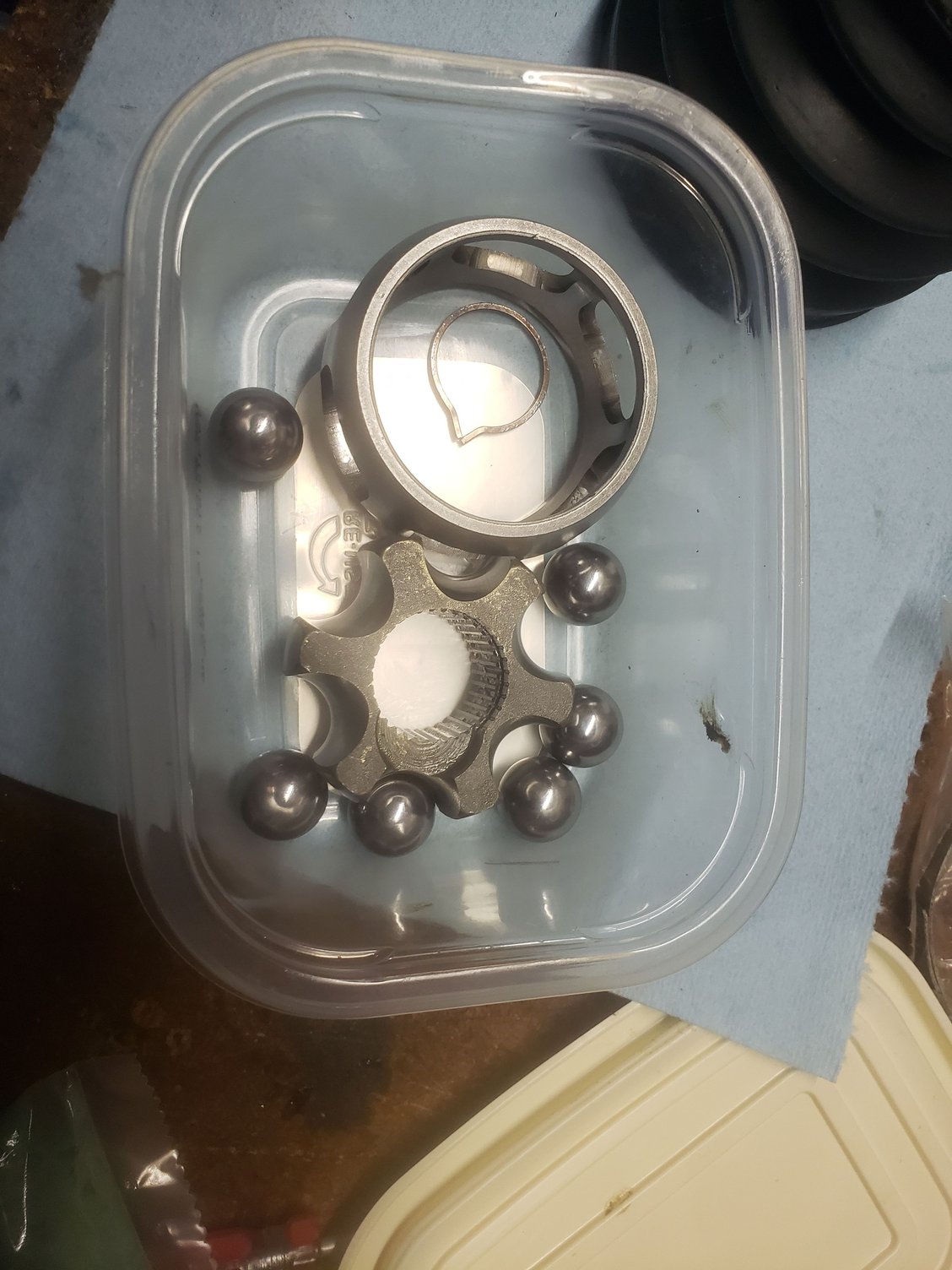

The parts for the cv joint.
The parts for the cv joint. I couldn't see any damage to them.

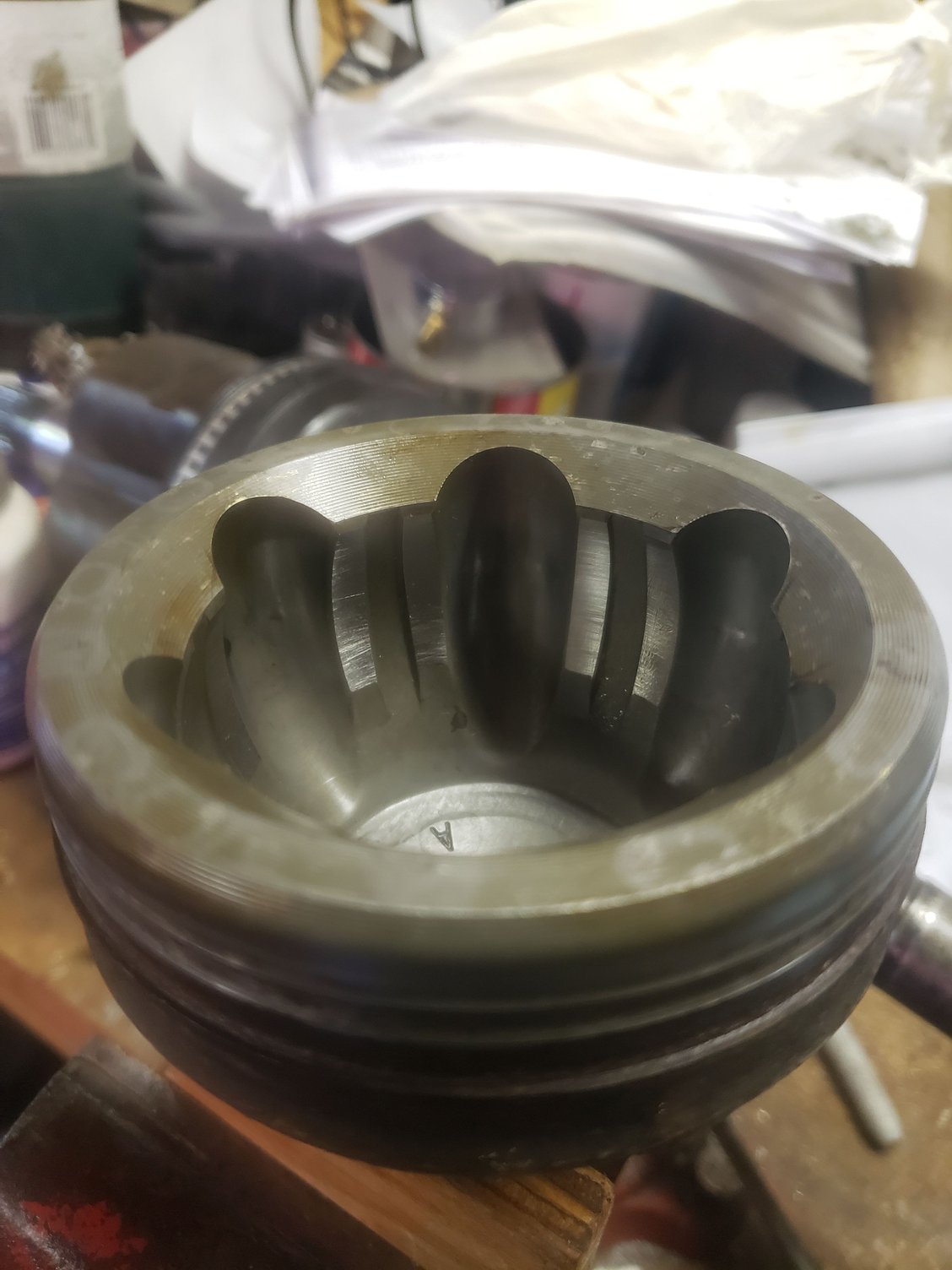

The outer race for the cv joint that is integral with the outer axle shaft.

If there is no play in the joints, then it is a good candidate for regreasing and installing a new boots. If the metal parts are worn or damaged, I think you need to get a whole new joint, e.g., from a good used axle.
The inner joints are the "tri-pot style and are easy. It is the outer one that gave me the headache. These are the true CV, constant velocity, joints with the 6 large steel *****.
If I were to try it again, I'd try to regrease the CV joint after disconnecting it from the axle without disassembling the ***** from the cage. Or if I felt I had to take it apart, I'd mark the orientation of the cage and inner race to the outer race. I'd then take the ***** out and store them in a marked egg carton so I could put them back in the same position from which they were removed.
I suspect that the reason I couldn't get my CV joint back together with it being flexible is because the ***** are in the wrong slots and the inner race is not correctly positioned either.
