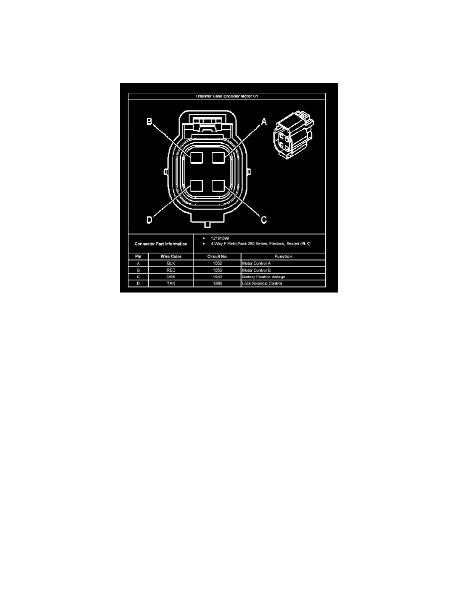

4x4 wont engage. Attached is picture of encoder connector.
I measured 16 Ohm on the solenoid and these values on encoder motor:
black-red: 1,2 kOhm
black-brown: 0
black orange:0
red-brown: 0
red - orange:0
brown-orange: 18 Ohm
Does this seem right?
