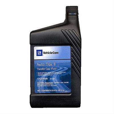

Have you changed the fluid in the transfer case recently? Should be done every 36K miles. If it hasn't been done recently, it might take a couple of fluid changes to free things up in the clutch packs. Fluid change takes almost 2 quarts of this stuff, available at any GM dealer, and there are no substitutions allowed:
Provided all 4 tires are the same circumference, (same manufacturer, same size, same tread wear) it should be fine to shift on the fly, on deceleration only.

Yes I changed it with that, been driving it around and going to change it again around 100 miles. I'm just wondering about the manual front differential in case the clutch pack wont free up.
