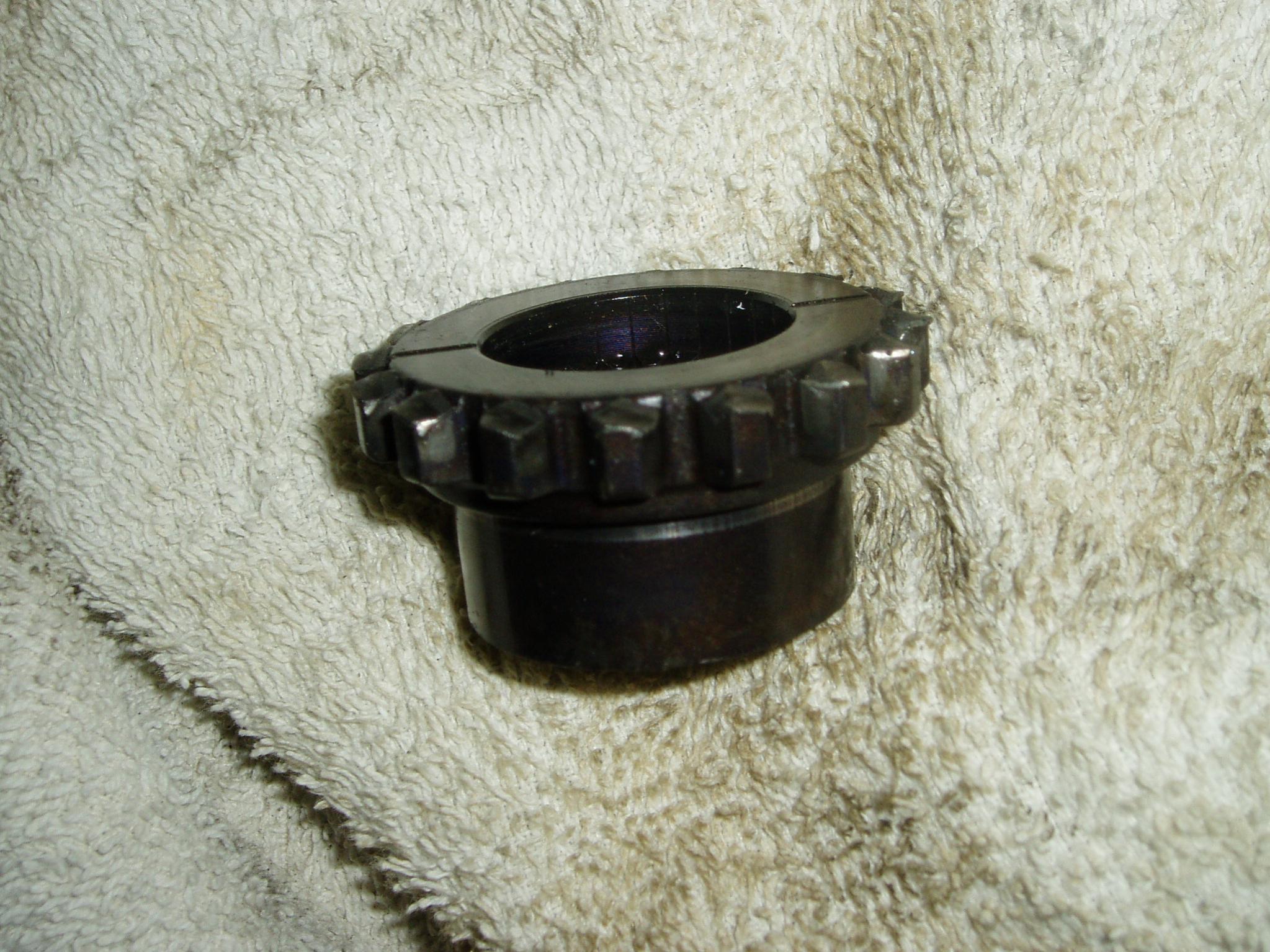

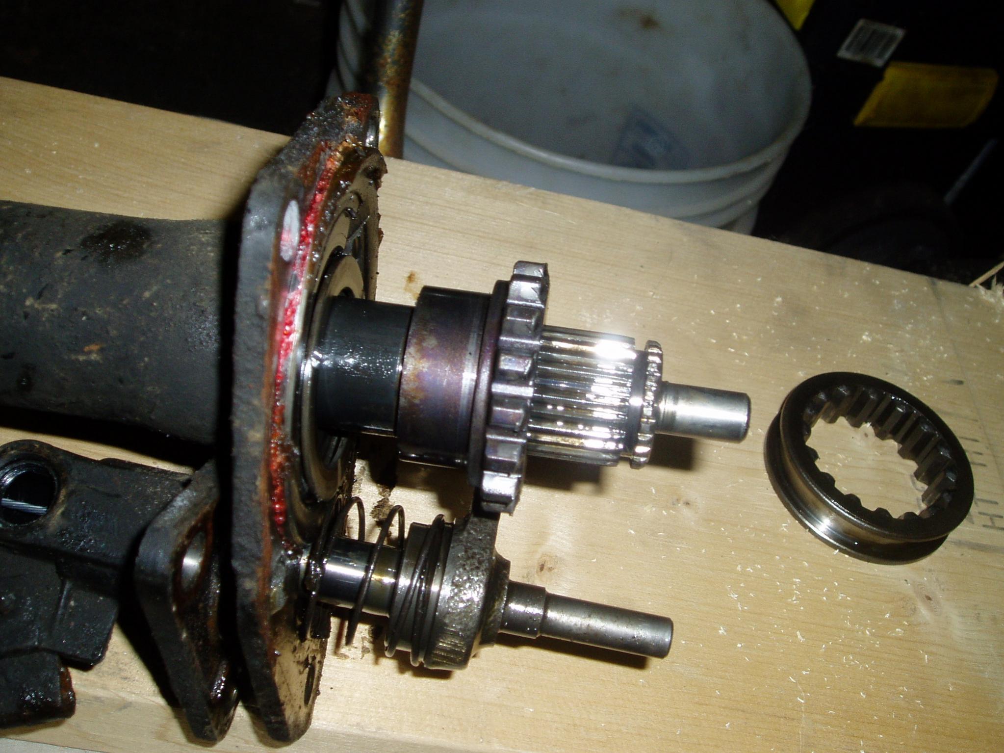

Old Feb 13, 2010 | 12:00 PM
layz680's Avatar
Joined: Feb 2010
Posts: 8
From: canton,ohio
layz680 is on a distinguished road
ok i took it apart today changed the upper ball joint . pulled the passenger side ext shaft. these are the best pics my junk camera. took a file and cleaned up the edges they was pulled over almost halfway.going for a test drive now since im warmed up its only like 28deg here. took me almost 5 hours not bad for my first time.
woo hoo my front wheels work now. and that roar roar in 2 wheel drive is gone now all i have to figure out why when in 2wd the front axel stays locked.
