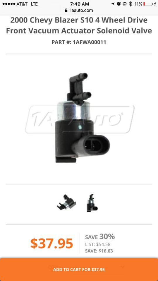

Sounds like the sleeve on the front axle disconnect is not engaging the right front axle all the way. thus giving you the whining sound.
I would check that by raising the right front wheel off the ground, start it up, put it in PARK and 4HI and see if you can move that right front wheel.
It should move a little each direction but stop. If it does, the front axle is locked in.
If not, could be the vacuum issue, or even a bad sleeve in the front axle disconnect.

Along the same line as was suggested by okaussie, put the vehicle in 4hi, and see if you can turn the front driveshaft by hand. If the transfer case is engaged properly you will not be able to turn the front driveshaft. If it is not engaged (or in 2hi) then the front driveshaft will spin freely. This will let you know for sure that the issue is related to the front differential.
Most likely okaussie is correct and the sleeve is not properly engaging the front differential. This is controlled by a vacuum solenoid under the battery. Following the test procedures described by okaussie, if in 4hi you can still spin the front tire, try squeezing the solenoid by hand to pull the cable (you will likely need to move the battery to access the solenoid). If pressing the solenoid by hand engages the front differential then the problem is insufficient vacuum. Quite possibly caused by a vacuum hose being disconnected or dry rotted and leaking.

Thank you for the advice. I have the Blazer jacked up. The transfer case is in four high. The front driveshaft does not move. The right front wheel does turn. A buddy said it might be the solenoid on the axle. Another friend, said it might be the vacuum switch under the battery. I have the battery out, but I cannot find the switch. Also, where is the switch of the front differential? Thank you.
