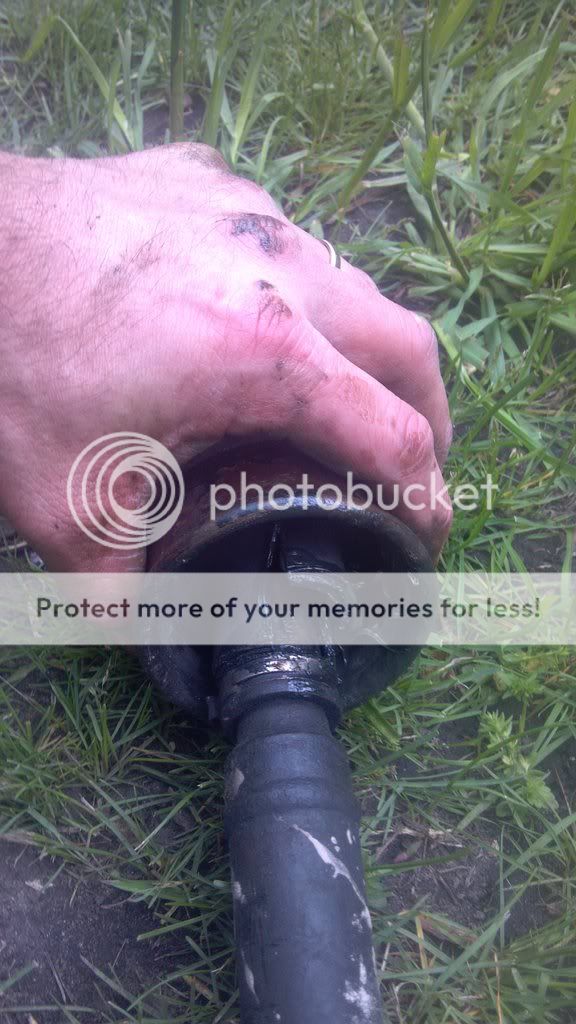

I searched and called around..does anyone make a boot for the front driveshaft cv joint?
Mine hass ripped...must have disturbed the dirt holding it together when i did tranny swap...local yards have the whole drive shaft but i would rather do the boot if possible
pic...this may help.

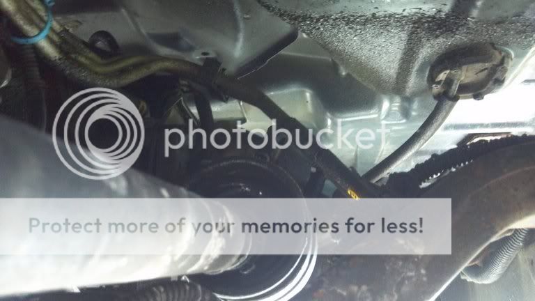

notice the lube trail on the underside of the floor boards.
Thanks guys

^^^^ your thinking cv shaft going from front diff to the wheels.
i damaged the front drive shaft going from the transfercase to the front diff.

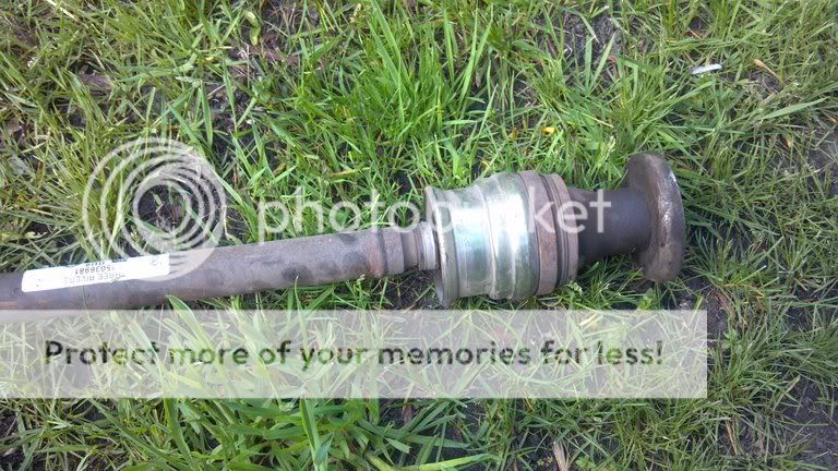

edit....ok here is my junkyard find, and it was 40.00 to boot.
thats the best part...it looks like new...even the u-joint looked new (minus the duct tape on the caps).
cant beat that!
here is the failed old boot
under closer inspection it was toast...the whole boot was just about to give way at the collar...rest in peace...you did your job well boot.
230k + miles...good job gm.
