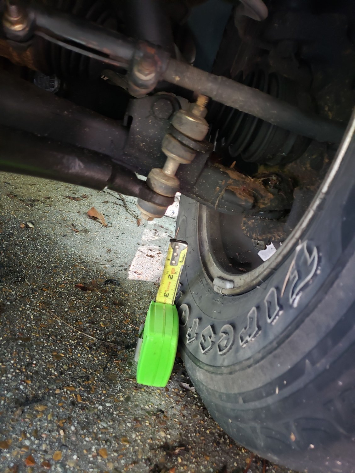

Hey christine. I've started to try to get it to specs but it seems hard to measure because the wheel is in the way. Am I doing this correctly?
Old Aug 3, 2020 | 11:04 AM
Yep, I think you are measuring the right points.
For the inner measurement, I think I used two bits of wood that I could slide past each other; kind of like a lower part of an "L" and the vertical part of an "L" used with the horizontal part on the top. I then would slide up the part with the horizontal leg against the vertical part until the top edge of the horizontal part touched the underside of the steering knuckle. I then either marked the pieces of wood with a pencil or added a clamp that would allow me to take the measurement.
You could also make a "go-no-go" gauge by cutting out a piece of plywood in the shape of an "L" that you invert and use to check the height. The height from the bottom to the top of the "L" would be the height you want. If everything was square, then you should be fine.
