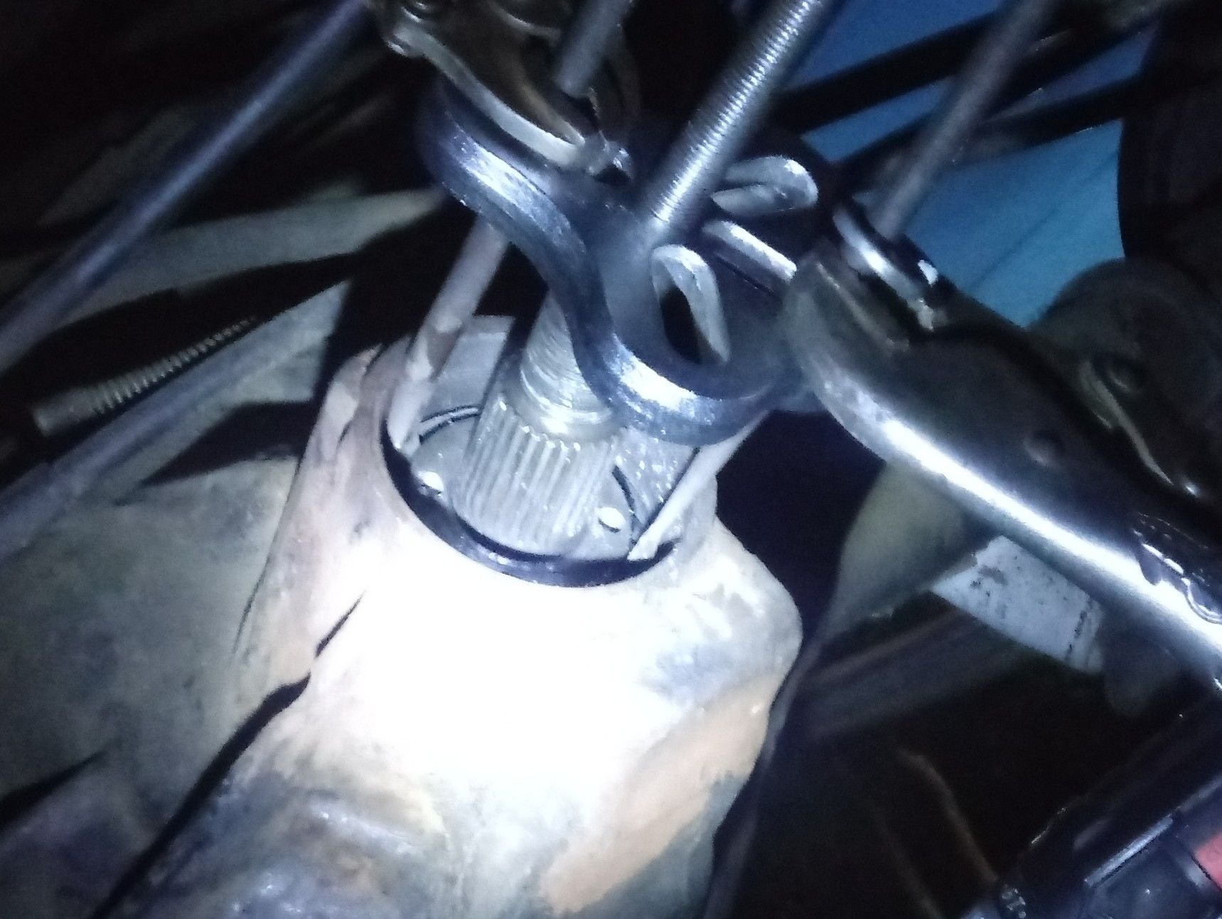

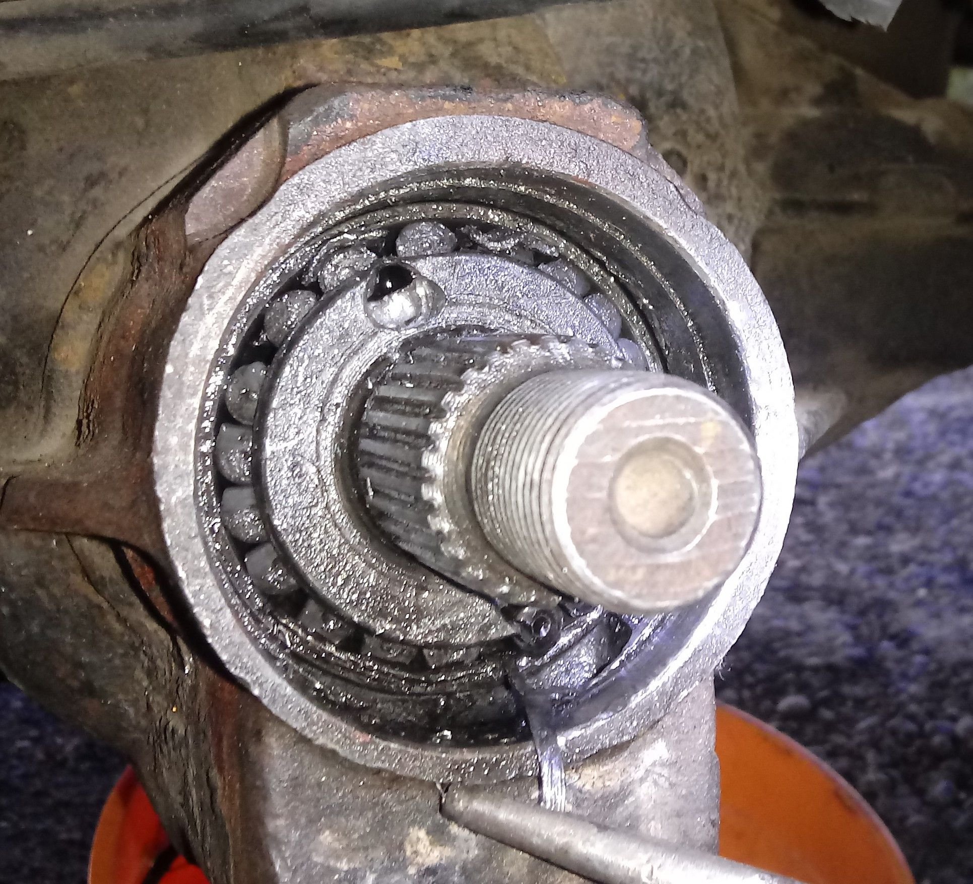

Update:Rear diff outer pinion bearing is basically shrapnel,and the inner race is fused to the pinion shaft.I've made many improvised tools,and attempts to remove it,but no luck.I'll try to post a pic of it with this update.In other news,front diff is working now,so I at least have the option of driving it instead of pushing it (lmao it's a 1/2 ton..very heavy) if I need to move it thanks to the info here on blazerforum.comI contacted the owner of the yard who sold me the replacement axle assembly,and he's working with me on another replacement.He said if those bearings are shot,the rest of the internals are probably toast as well,and that I should just get a new diff,but I looked and haven't found any damage at all..only metal flakes on the magnet,not the gears.Question is,do I repair or replace?He wants another hundred bucks for labor to pull another one,and although they deliver locally,he said that's not an option..meaning I have to figure out a way there and back with it.I appreciate any advice you guys might have,and I'm extremely grateful for the knowledge I've found here.Thank you!

It will take a ring/pinion + both pinion bearings minimum to fix this rear if the housing is still good. You obviously don't know how to set up a rear end by your comments, so I would not recommend you try to patch this one. Just get another rear from the junk yard.

I agree with Les. You may not be able to see any damage, but all those shavings circulated through the gears and bearings for who knows how long. That thing is toast.
It looks like you drilled the inner bearing race in an attempt to pull it out. Just the fact that you were able to do that tells me that the bearing got WAY hot and lost its hardness. Chances are, the pinion did, too. To fix it right, you're going to be into it at least a few hundred dollars, without labor. You'd be bucks and hours ahead to replace the whole assembly. That CAN be done on the side of the road (or under a shade tree) in a couple of hours.
Old May 16, 2020 | 09:20 PM
Agreed with the previous 2 posts.
Setting up that preload on that bearing can be a tricky task, especially on the side of the road. Set it up wrong, not only could you cook the new bearing, but destroy the ring and pinion gears in the process.
You would be much better off just swapping out the entire unit again.
