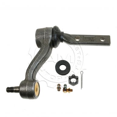

This is the pitman arm and it attaches to the steering box.
Idler arm looks like this and it attaches to the inside of the frame on the passenger side
Also you may want to look into just buying new control arms with bushings installed already cause the bushings on them have to be pressed in and out and you can get them pretty cheap already installed then its just a bolt on thing and way easier IMO.
