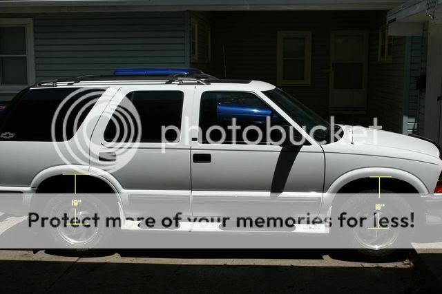

Edit - - OK, so I was out putzing around with my Blazer I noticed that I don't have a rear end problem. I am actually lower in the front. here is a pic:
Is this difference in ride height normal? If not what can I do to Remedy it? Also right now I am running P235/70/R15. What is the best recommended size I can go up to without major rubbing issues? I was thinking 30's but but I don't know jack when it comes to tires.

30x9.5 is the biggest without rubbing. That difference sounds normal...usually it's only an inch up on the tbars to level a blazer out. Hows your ride? You could still have saggy/worn leaf packs..

Are you talking about the notorious S-series lean? if not that then id say check your shocks, if its the "S" Lean then Belltech makes a kit 1" coil spring spacer to level it out. If its 4x4 then torque on that torsion bolt on the side that leans. Hope that helps

leaf spring = rear end. The lean is all front end issues. And shocks don't really control height all that much...they're more of a damper for small impacts to the suspension.
