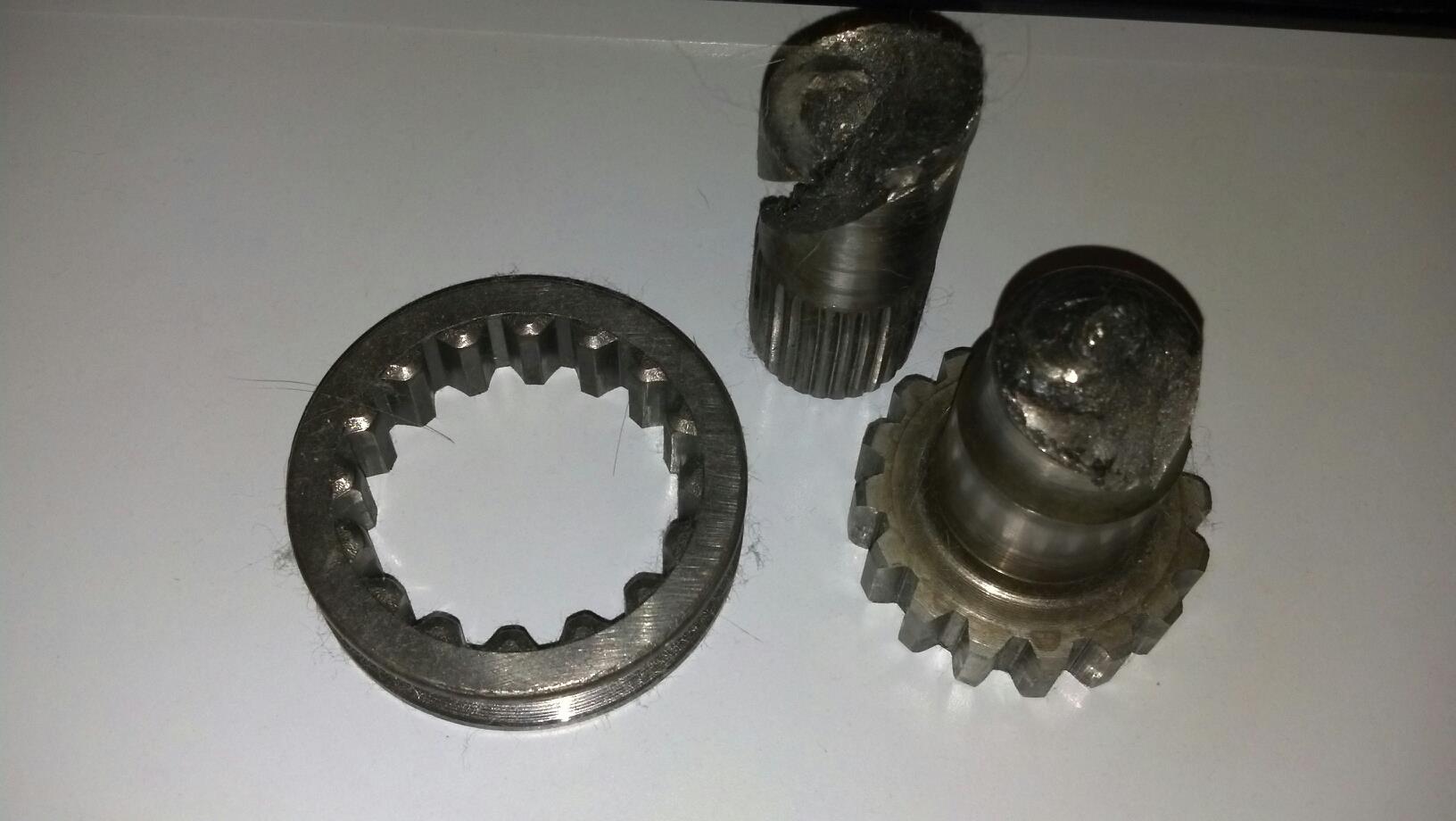

This is what happens from driving with the front axle locked in on blacktop. My 04 s10 had a BAD vacuum switch on the t-case leaving the axle locked in all the time.
Well that is interesting...what kind of sound did that make?
Old Dec 14, 2012 | 11:29 PM
Blazin00LT's Avatar
Joined: Oct 2012
Posts: 241
From: Greenfield
Blazin00LT is on a distinguished road
It was a very loud pop.

Originally Posted by J_E
Leaving the front axle locked is fine as long as the tcase is in 2wd, unless you have a non selectable locker in the front axle (such as a Detroit or Aussie). There are plenty of jeeps setup like that. The only problem is that you get a little bind when you make sharp turns, such as when pulling into a parking space.
An auto locker in the front has almost no affect on turning(edit: in 2wd). they make a bit of noise though.
