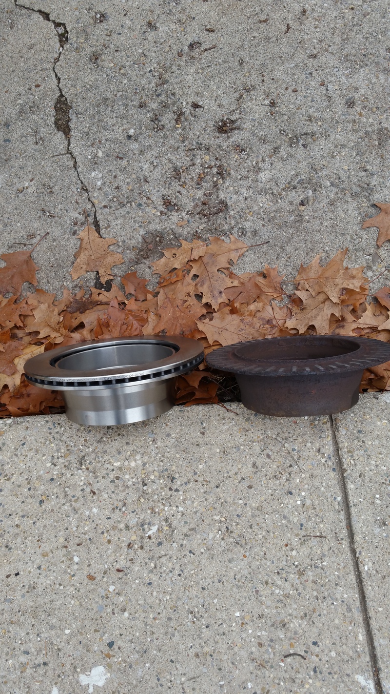

Already posted the story about why I had to change my rear rotor, but during the process I ran across something odd.
Here is a side by side shot of the new and old rotor. Looks like something is missing from the old one.
My question is: Has anyone else seen this before? Was this something that happened over time? Or does it look like what my dad and I think and someone cut part of it off? We did have one heck of a time getting the new one to fit properly, so that's why we are thinking they removed part to make it fit. If it is something that can happen just by driving, any ideas on what would cause it?

My sister was good at allowing her car to go WAY beyond time to service the brakes and eating the rotor. Rear brakes are often neglected as they really do not lend much to the total braking force of the vehicle.
What happens most often is the sliders fail and the outside pad grinds away until there is an audible noise. But the caliper pistons can freeze along with the sliders and grind away as well.
Most likely, what happened here is rust got to the rotor and caused the inner pad surface to break free from the rest of the rotor where it then snapped and fell off.

ive seen that happen a few times. whats funny is most the time i drive the car before you dont really hear any grinding or funny noise. ive seen people wear them down so thin the hat actually busted off from the braking ring.
or seen solid rotors get worn down paper thin so it was like a giant razor blade. most the times customers dont bring their cars in until the piston in the caliper actually shot out

Thanks for the info. I figured it was possible, just have never seen it before, on any vehicle I've owned. Haven't done the driver side yet, due to time constraints, will probably go ahead and pick up another rotor and replace that side as well when I do the pads. It's probably pretty rusted too.

I had rotor that weren't as bad as that, but getting close on one of the trucks I bought. I'd look at changing the calipers too. One of the calipers on mine had cracked, I'm guessing from the impact loading of the rotor fins. Plus if you had a hard time getting the calipers over the new rotors then them might be too corroded to open all the way.
