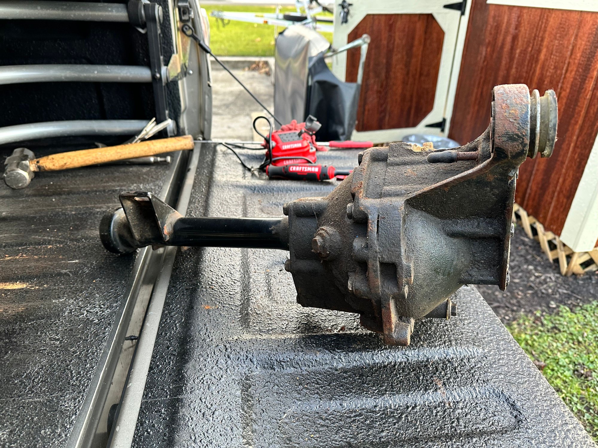

Grabbed an iron front diff from a zr2 this weekend. Grabbing a rear also. Gonna swap them into my 01 non zr2. I’ll be running the 3.73s with the 235/75 tires. Hoping it’ll help a little with towing my seadoos over the summer. Anyone else running 3.73 gears and 235s.
or my other idea was into my truck and regearing to 4.56s and 6” lift with the 3” body lift and going with 33-35s

yes they will bolt right in no problem. I’ve done all that research. Just wondered to guys with 235/75 tires how the driving was with 3.73 gears. And no the zr2s did not have 4.11s. All were 3.73s.

Can confirm that the ZR2s came stock with 3.73 gears, and any different gears were custom options.
The rear axle and front diff will bolt right in place, although the front diff to CV connections were different 95-97 (bolt on style) vs 98-05 (splined plug in style). The CV axles are 2-3" longer on the ZR2s though, and are not compatible with a non-ZR2. Christine is correct that the ZR2s had different frame mounts for the control arms, moving the locations lower, and outboard to give the ZR2 higher & wider stance, necessitating the longer CV axles.
Keep in mind too that the ZR2 rear axle is 3" wider than the non-ZR2 4x4 axle. Swapping the ZR2 axle into a non-ZR2 truck will make the rear track about 1" wider than the front track width.
