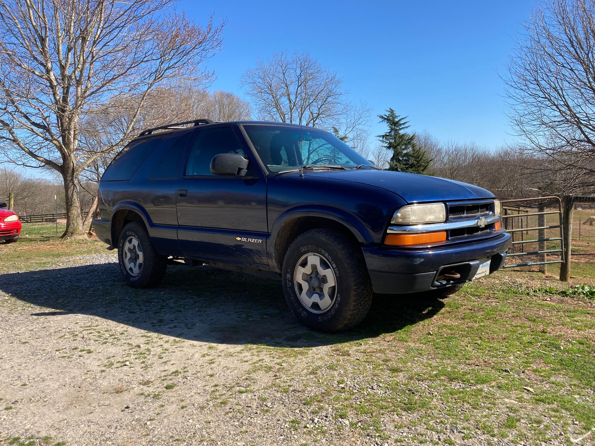

That looks sweet! I’d love to get mine looking like that. It certainly has potential. Again, thanks for the info! I think I’ll be trying to find a ZR2 to swap the rear axle and the front diff into mine. Also want to get the rear tire mount off of one to get my tire out of the cab. This is what mine looks like right now except I just painted the tow hooks red. I only paid $800 for it since it had a misfire which I’m currently fixing.

It's a solid looking ride to start with. And can't complain for that price.

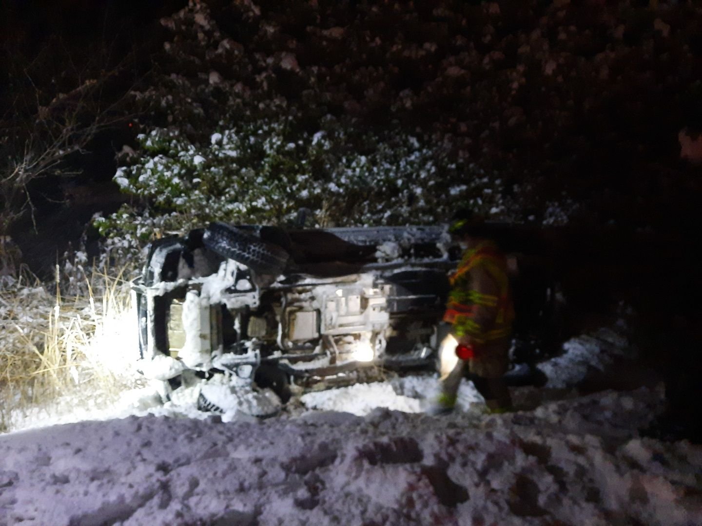

https://cimg7.ibsrv.net/gimg/blazerf...1ac8e0a0b.jpeg
The day it went into the ditch. Evwrything went flying, but nothing broke.
