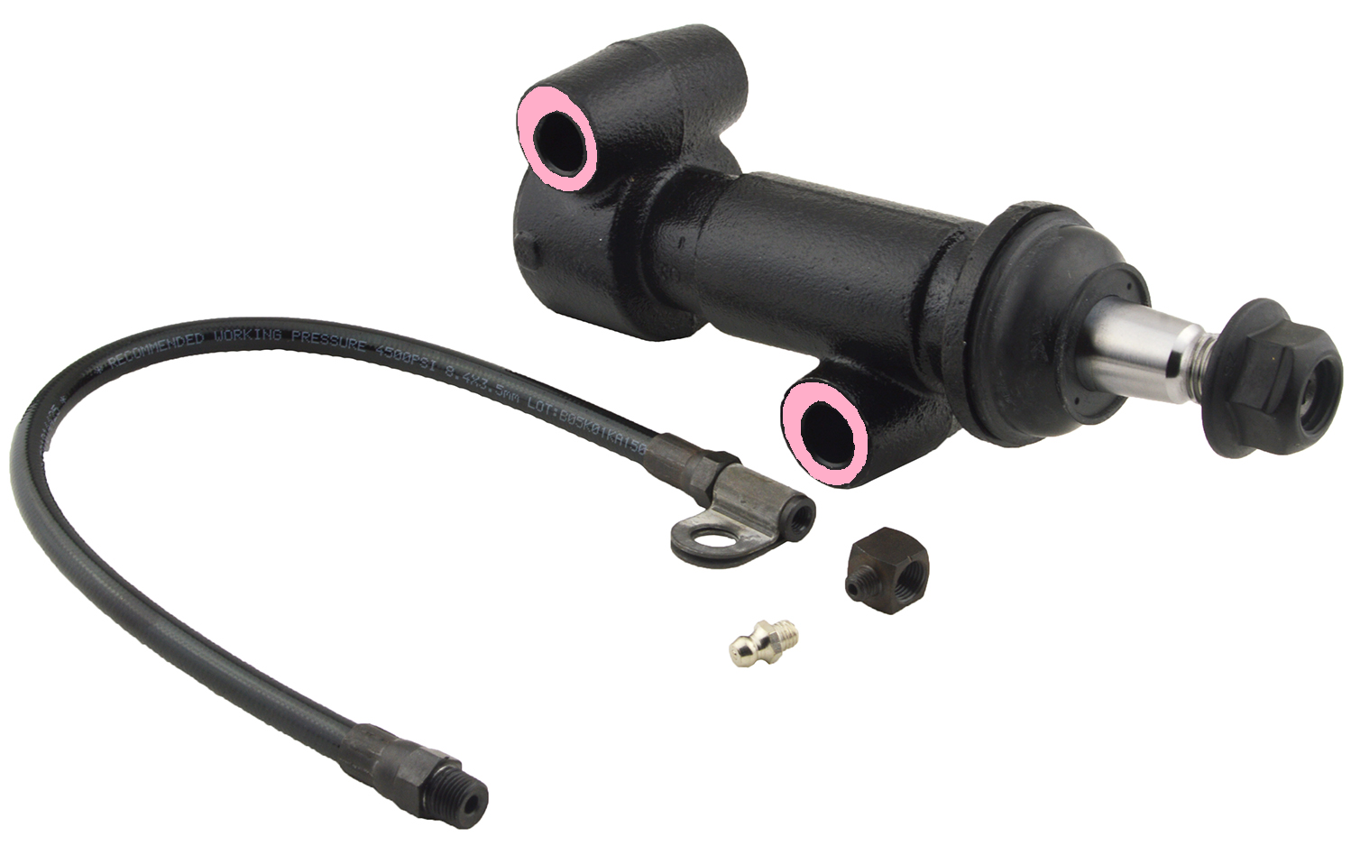

Originally, I purchased Proforged parts, the idler arm pivot (102-10033) and the idler arm (102-10026). However, I was not happy with the idler arm in that it didn't use a castellated nut and cotter pin to secure it, instead using a nylock nut. I've since gotten a Moog idler arm to attach to the Proforged pivot.
I did test fit the Proforged idler arm pivot to the Outfitter design mounting bracket and got it to fit with just a tad of filing on the faces of the the mounting bolt hole flanges. It didn't take much to get it to fit. Is this the fitment issue to which you are referring?
I'm hoping to get to doing the installation in the spring now that I have a replacement mounting bracket from Outfitter design since the original didn't seem to fit to the frame correctly.
Where I had to file to make the idler arm pivot to fit are in pink.

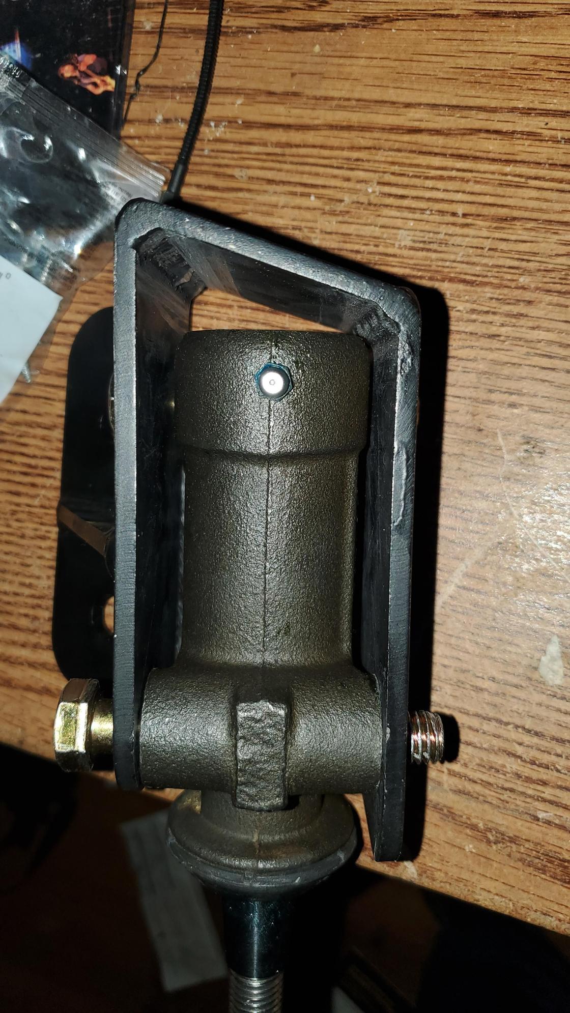

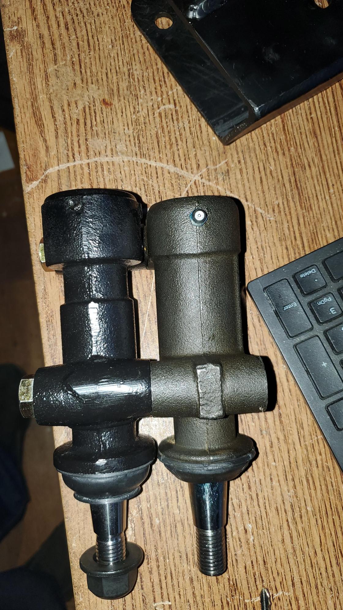

The Proforged part is one the left and you can see how it is taller and has bigger bearing than the Moog. I returned the Proforged parts. The truck aligned and drives great with the Moog parts.
Tbis how the Moog part fit.
I spoke with Will at the msnufacturer and they will update their bracket welding procedure.

Thanks for posting this! The Proforged pivot bracket fit on the original adapter bracket but I didn't think to see if the Proforged would fit the replacement one. I just now tried it and it won't fit. It is close but as you pointed out, the higher body interferes with the inside of the adapter bracket.
Now I gotta figure out what to do.
