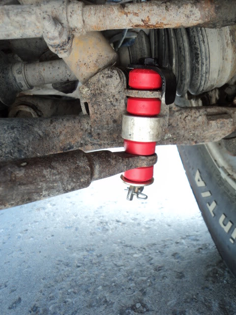

It's a matter of making the sway bar end links removable without tools. Here's mine.
Dilled a hole for a pin to keep the wing nut from backing off, and welded a tab to the top to keep it from spinning as you tighten or loosen the wing nut.

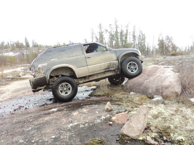

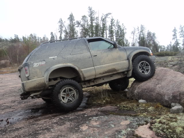

And here's how much of a difference it makes
Connected:
Disconnected:

Yeah I like how Jamaroon welded the tab on his! I didn't have that capability at the time I made mine I can take mine off with a pliers easily enough tho so I'm happy with them.

how long is the bolt?

I just got the stock replacement end links and modified them. So whatever length that is.

2- 3/8 x 4 inch grade 8 bolt
2- 3/8"-16 wing nut
2- 3/16" x 1-1/2" linch pin
1- universal pack Energy suspension sway bar end link bushings
Thats what I used anyway

and what did you do to keep the sway bar out of the way while disconnected?

I pull mine all the way forward and tie it up with a strap. I would like to figure something better out eventually but it's not a priority right now.
