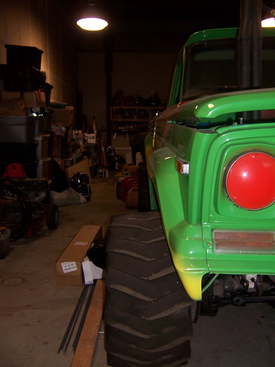

you sure they weren't 31x15.5r15?
like truck puller tires?
Attached Thumbnails 31" x 16.5" on stock jimmy rims?-100_0926.jpg   31" x 16.5" on stock jimmy rims?-100_0938.jpg
