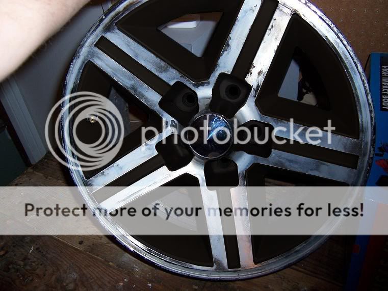

So my question is this: Can I sandblast aluminum Rims? I know rough sand does a good damn job on steel, but i think it would chew the hell out of aluminum. So what is the best media, and does anyone have any tips/tricks that can make this smoother? I know glass blasting (beads) and even tree-hugging walnut can get the job done, but i have silica sand on hand, and don't relish the idea of sanding these rims down by hand....
was done with green scotchbrite and acetone. sucked too. half-hearted, and half-assed... but I want to do this right so I can rock some 265/70r16's before summer ends...

Silica sand would be fine, just don't breathe it! Sure you already knew that though. Are you planning on painting them after or polishing them?

As has been said, you will have no problems sand blasting the aluminum rims. Obviously you don't want to sit at one spot for too long and you do not want to get too close, but those are general sand blasting rules to follow.
I blasted (glass bead) a set of Intrepid rims that I was planning on polishing up when I owned an Intrepid:
