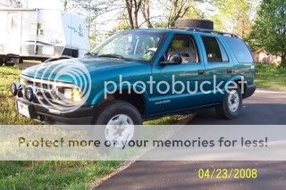

Well the backspacing is 4.5', which is 1.5' less than stock on each side, so that's 3' wider...then my rims are 15x8 which is 1' wider than stock, and with my rims minimal offset, that should equal out to another .5' wider on each side. All in all, ~2' wider on each side, or 4' wider from total.
Remember exposed tread laws...some states will require you to have fender flares for the wider stance, which adds a signifcant cost on if you have a 4-door or non-z 2-door.

265/70/15s convert to be 30x10.50s. But the General Grabber AT2s work out to have actual dimensions of 30.4x10.7...so I like 'em

oh ok do u think if i get this kit http://cgi.ebay.com/ebaymotors/ws/eB...middle:uswould i be able to get 31s?
that is actually the kit i was tlkin abt!!!!
how is your push bar mounted????
