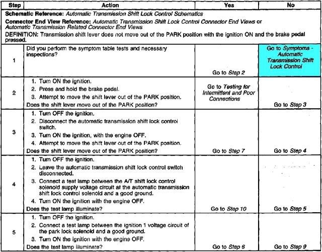

Diagnostic flow chart for the Shift Interlock solenoid/switch and the symptoms you describe:
