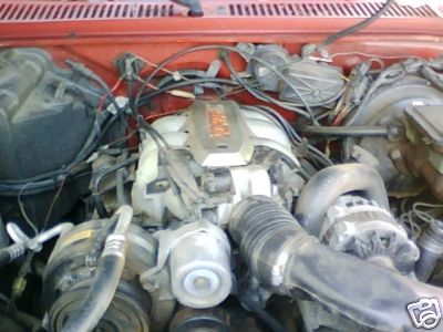

I was wrong I believe this set-up is CPI, correct me if I am wrong. The 2.2 was a MPFI. So I will need to know what fuel pressure to run these at and if they are compatible.

Yes, that is a CPI motor. And yes, the fuel pressure will be the same for the two. Hopefully the fuel pump can flow enough to support that engine.
