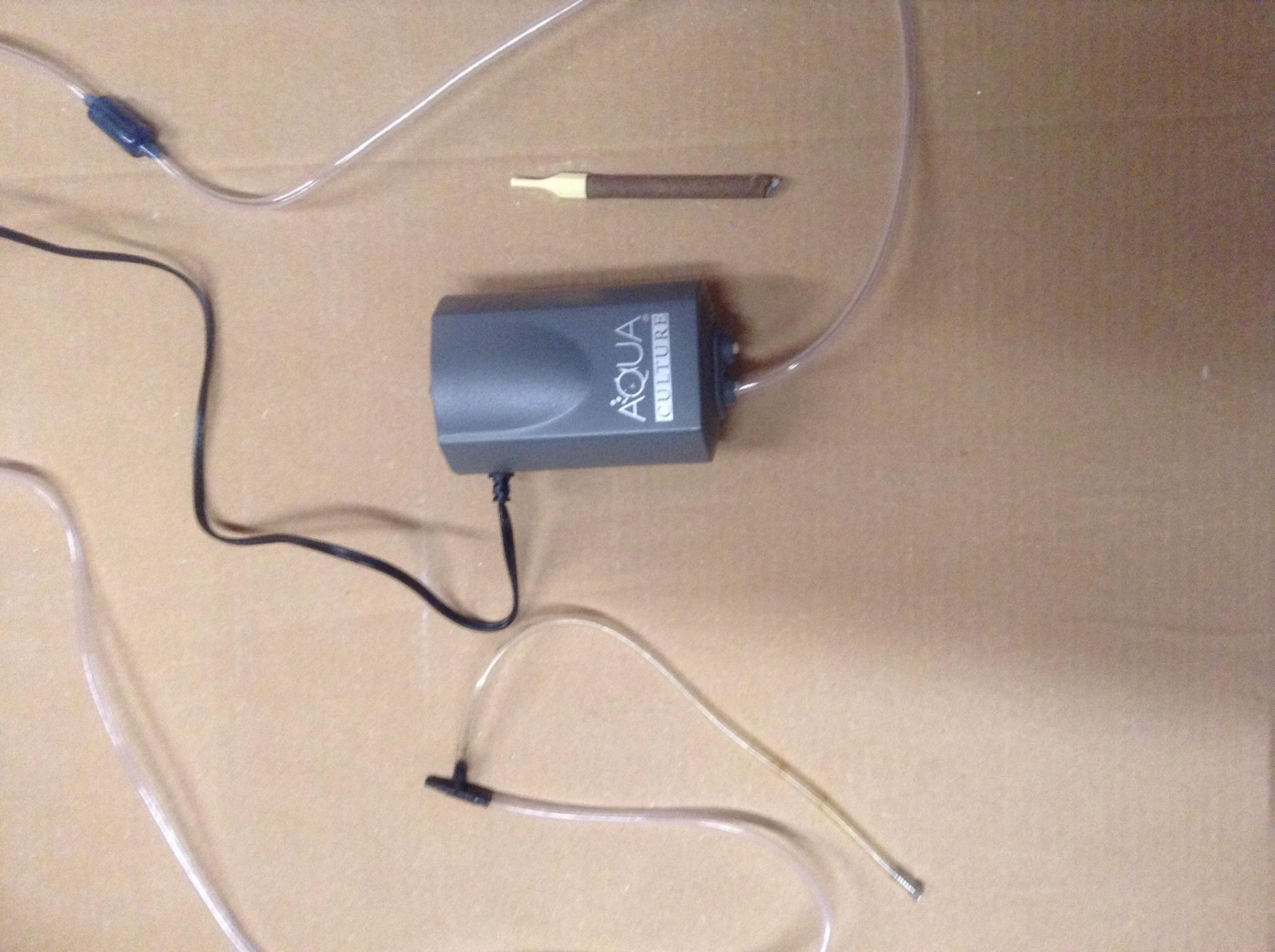

More troubleshooting. Made me a redneck smoke tester! Got a cigar an aquarium pump, some aquarium hose, and a rubber glove. Taped the glove over the throttle body butterfly hole, hooked the air pump (2 psi) up to the cruise control vacuum line with a three way so i could blow smoke in. Lit the cigar, blew smoke in plugged up the hole and turned the pump on. The glove expanded and heres what I found:
Vent tube off the xfer case was blowing air (the one that started this whole thread).
Plugged it, couldnt find anymore obvious leaks.
Turned the pump on again, blew a ton of smoke in and plugged the hole. Looked and looked for stray smoke around the intake, all the hose connections, the vac ball...nothing. Couldn't hear anything either. Even tried spraying a little soapy water everywhere, no bubbles.
Turned the pump off for a "bleed down test" it held pretty good. Pulled the vac hose off of the vac ball and smoke bellered out(good sign i guess?)
Conclusion? I think my xfer case three way switch is hosed and leaking vacuum, gonna replace it.
Any thoughts?
Doing a fuel pressure leakdown check tomorrow. Got a vacuum gauge coming in the mail just for a sanity check. Crossing my fingers.

Default Smoke rig
Heres my quick smoke/pressure test rig. Works pretty good.
