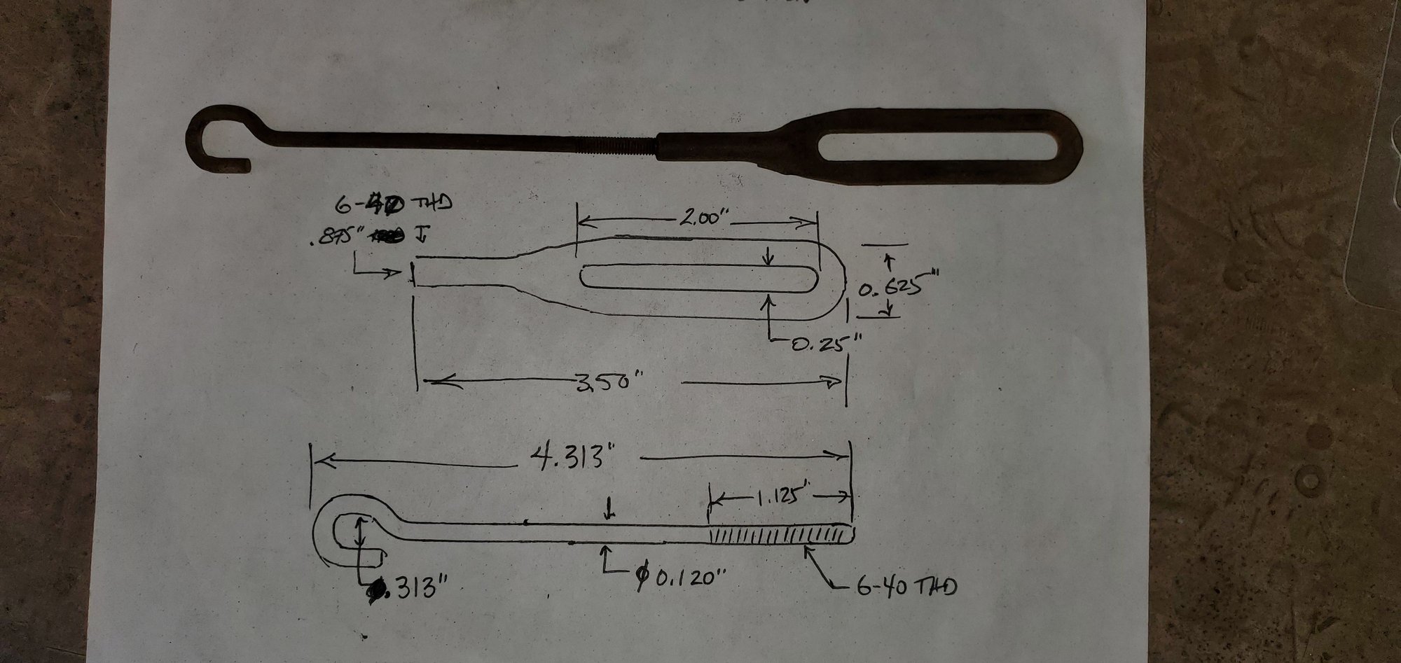

Guys I am looking for the cruise control arm that connects the servo to the TBI on a 1990 Chevy 1500 Blazer. If you have one contact me at “wam1653@aol.com” of if you can give me the length dimensions of the wire and the flat TBI end as well as the opening in the TBI throttle connection (the slot dimensions) that would help me fab one.

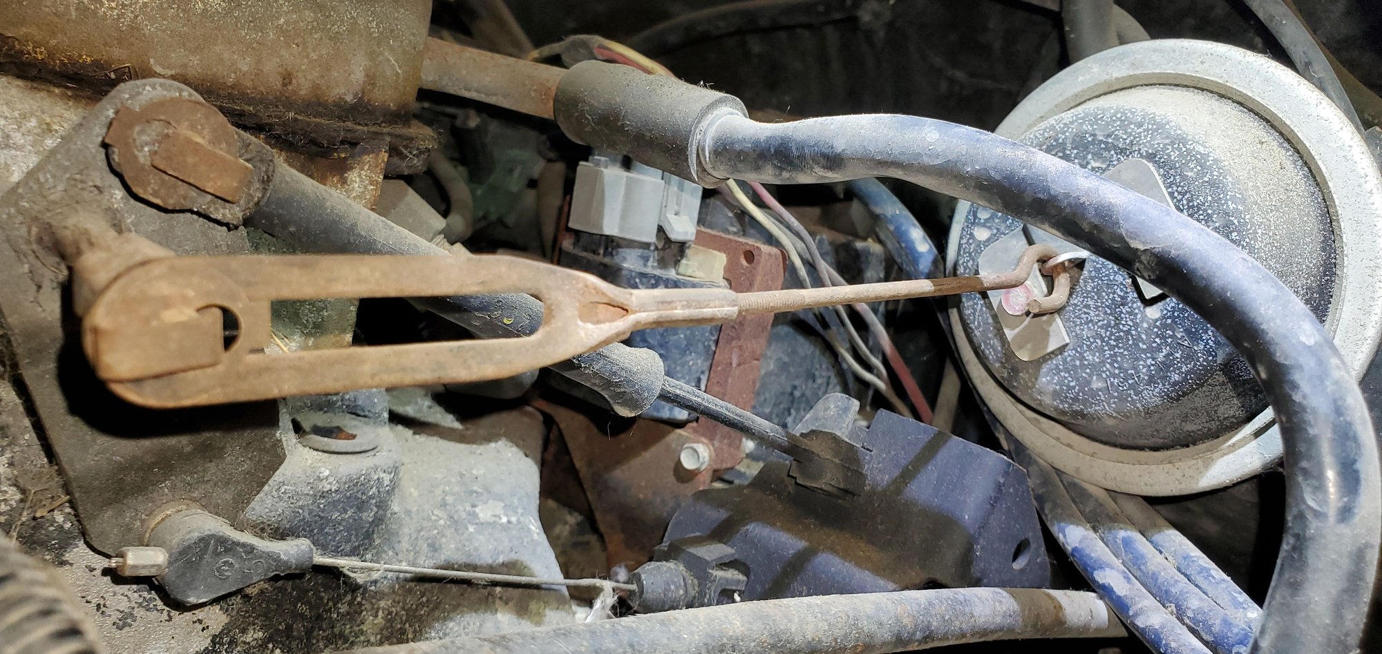

I have a 1990 'burb sitting in my barn that I can likely get some dimensions off of for you. I have plans to use the motor in my '74 at some point and would like to retain cruise control when I do so. I'm planning on using the TBI motor & moving over all of the dash components along with the A/C to my '74.
I'll look at it hopefully today and get you some pictures as well as measurements.
*EDIT* Here are the dimensions off of the cruise control linkage on my 90' burb TBI 350. Overall length was 6.813" when assembled, but yours may need to be adjusted to suit your collection of parts & mounting.
1990 TBI 350 cruise control linkage dimensions

Thanks.
That's what I needed. I really appreciate the help.
