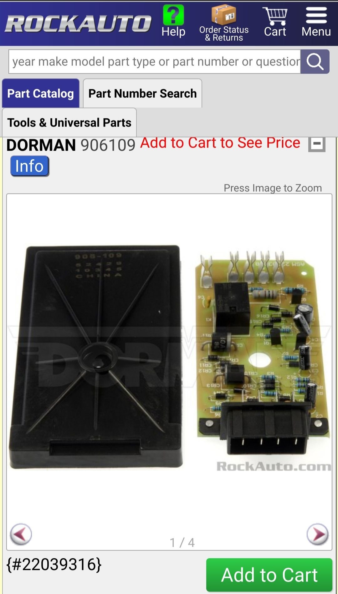

Mine had a similar problem, but the opposite. Mine kept shutting off in a downpour, about 100 miles from the house on a vacation. After some research, I found a lot of vehicles suffer from issues with the wiper motor pulse board. Found it on Rockauto.com. One screw, one wire connector replacement. Super easy. Including picture of part.
