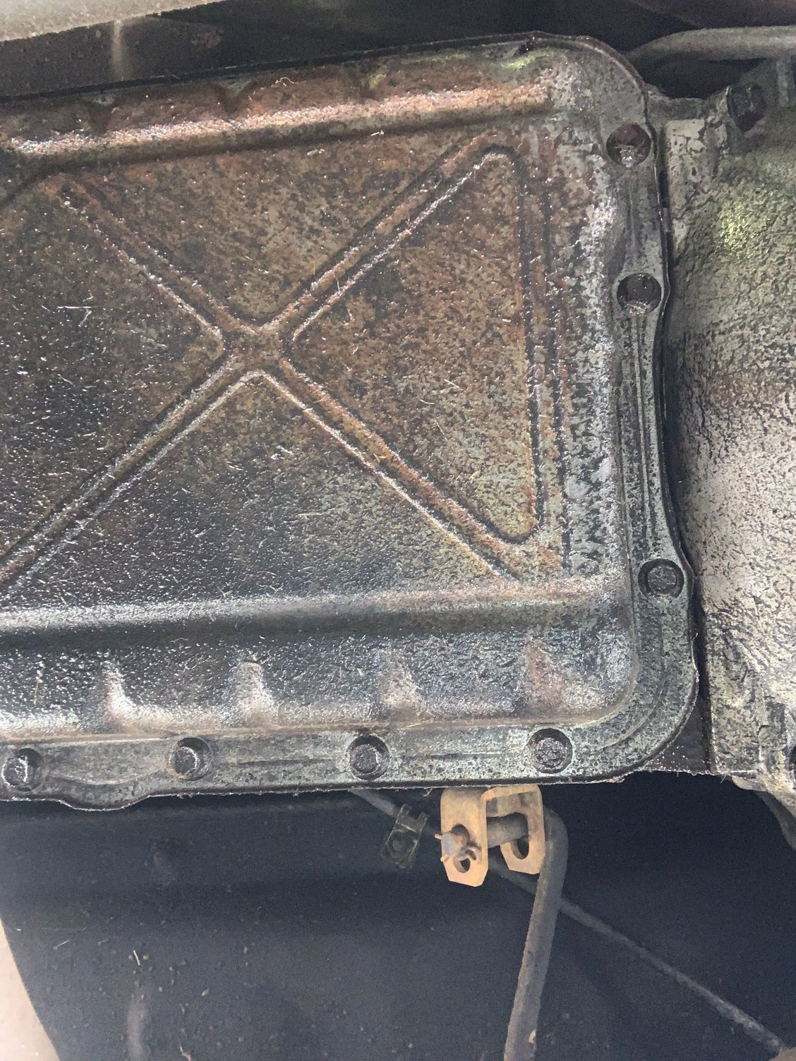

Post a picture of the transmission pan and we should be able to tell you pretty quickly. The TH400 pan kind of resembles the state of Texas, while the 700R4 is more square.
looks more square
Old Oct 8, 2022 | 02:03 PM
Definitely NOT a Turbo 400.
